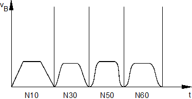

Programming Example
Select the operation mode
N10 G01 X50 Y10 Z0 F1000      (step-shaped accel.profile, default)
N20 #SLOPE [TYPE=TRAPEZ]      (trapezoidal accel.profile)
N30 X10 Y30
N40 #SLOPE [TYPE=SIN2]      (sinusoidal accel.profile)
N50 X15
N60 Y50
N70 M30
The following velocity curve results on the programmed path:
Selecting operating mode (#SLOPE, #SLOPE DEFAULT) 1:
Velocity curve depending on the programmed path.
