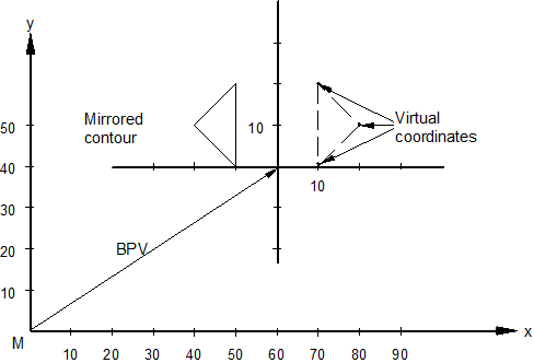

The term "virtual coordinates" is used to mirror in the plane. When mirroring is executed, the virtual coordinates (xm) are the values entered in the NC program. By contrast, the real coordinates (xr) are mirrored and are executed in reality. Mirror functions always act on the first and second main axes of the current plane (G17, G18, G19). The third main axis of the current plane is not mirrored.
The following mirroring functions are available (illustrated example for G17, X-Y plane): | ||
G21 | Mirroring programmed paths on the X axis | modal |
| xm = -xr |
| ym = yr |
G22 | Mirroring programmed paths on the Y axis | modal |
| xm = -xr |
| ym = yr |
G23 | Superimpose G21 and G22 | modal |
| xm = -xr |
| ym = yr |
G20 | Deselect the mirroring function | modal, initial state |
xm , ym | Virtual coordinates |
xr , yr | Mirrored coordinates |
xa , ya | Absolute coordinates |
Contours to be mirrored should be specified in a subroutine. This subroutine is then called after the mirroring function. Mirroring is modal.

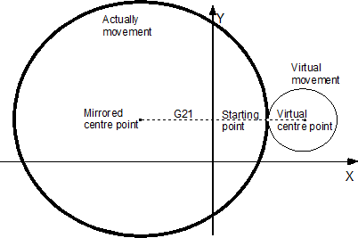

Note the following when circles are mirrored: In general, only coordinates set in the NC program are mirrored (i.e. only the centre point coordinates for a full circle). After selecting the mirroring function, the motion path runs directly to the target point. The starting point of the motion path is not mirrored. Consequence: In the motion block only the target point is mirrored but not the complete motion path (see Fig.: * Mirroring the target point in motion block”) Effect: If a full circle is programmed as a motion block and the starting/target points are not in 0/0, a new circle radius results from mirroring the centre point coordinates and the contour is changed (see Fig.: "Changing the contour when mirroring a full circle”). |
Effect:

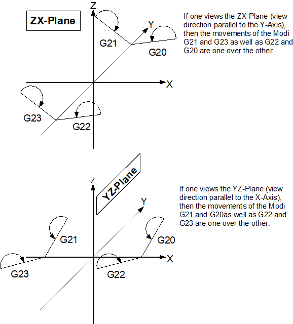

3D considerations:
If the mirroring functions are selected in a different plane than the XY plane (G18, G19), note that the direction of rotation for circular interpolation may change depending on the selected plane: In addition, mirroring has no impact on the Z coordinate, i.e. the virtual and mirrored values in the Z direction are always identical.
