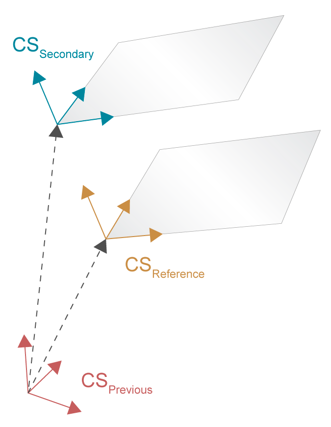

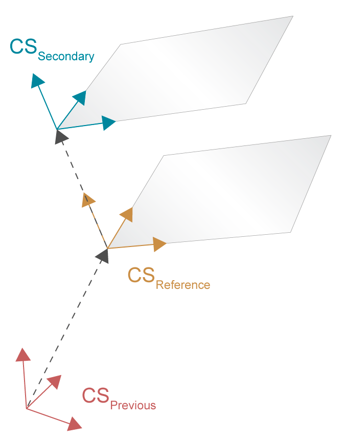

There are 2 options available to define translatory and rotary offsets:
Option 1
Option 2
Definition of lower and upper plane 1:
Definition of lower and upper plane 2:
Options to define the source reference of the reference and secondary CS
The default setting can be configured with channel parameter P-CHAN-00396. The valid option with the NC command #CS MODE is set in the NC program.

Option 2

Option 1, initial state

If rotations are also involved in the definition, option 1 complicates the description of the secondary CS. For example, an offset of the secondary CS by 10 mm in the Z direction must be programmed as follows:
#CS ADD [PCS][50,50,0,10,5,0] [50.85831, 48.26351, 9.81060,10,5,0]
Alternatively, programming is simplified if the secondary CS is defined relative to its own reference CS as per option 2:
#CS MODE ON[2ND_ON_ACTUAL_1ST_PATH]
#CS ADD [PCS][50,50,0,10,5,0][0,0,10,0,0,0]
