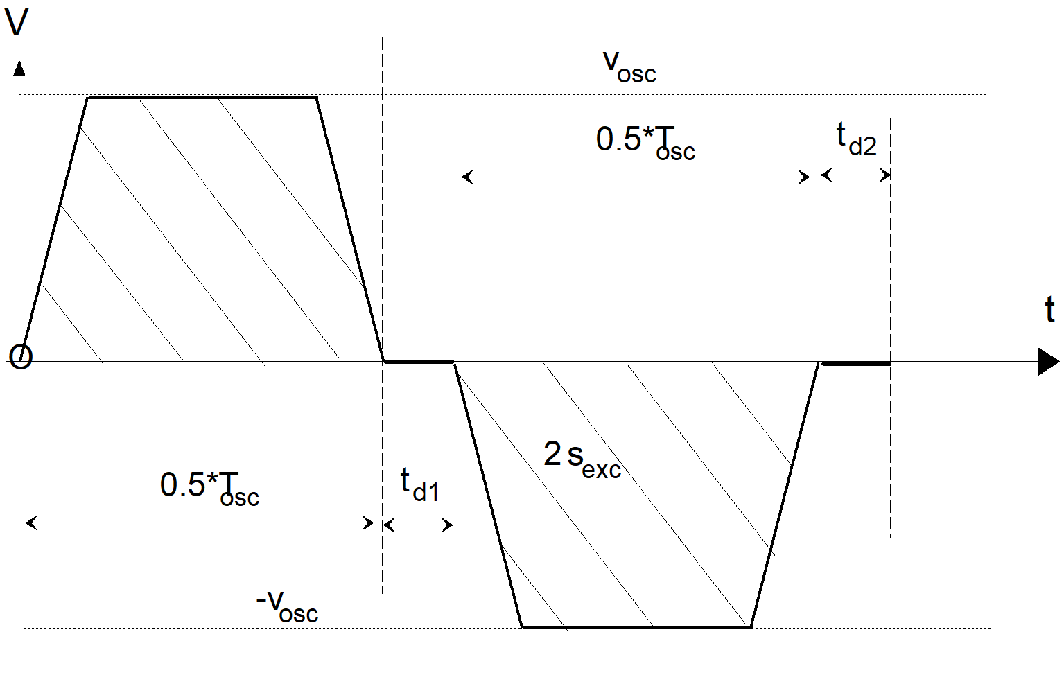

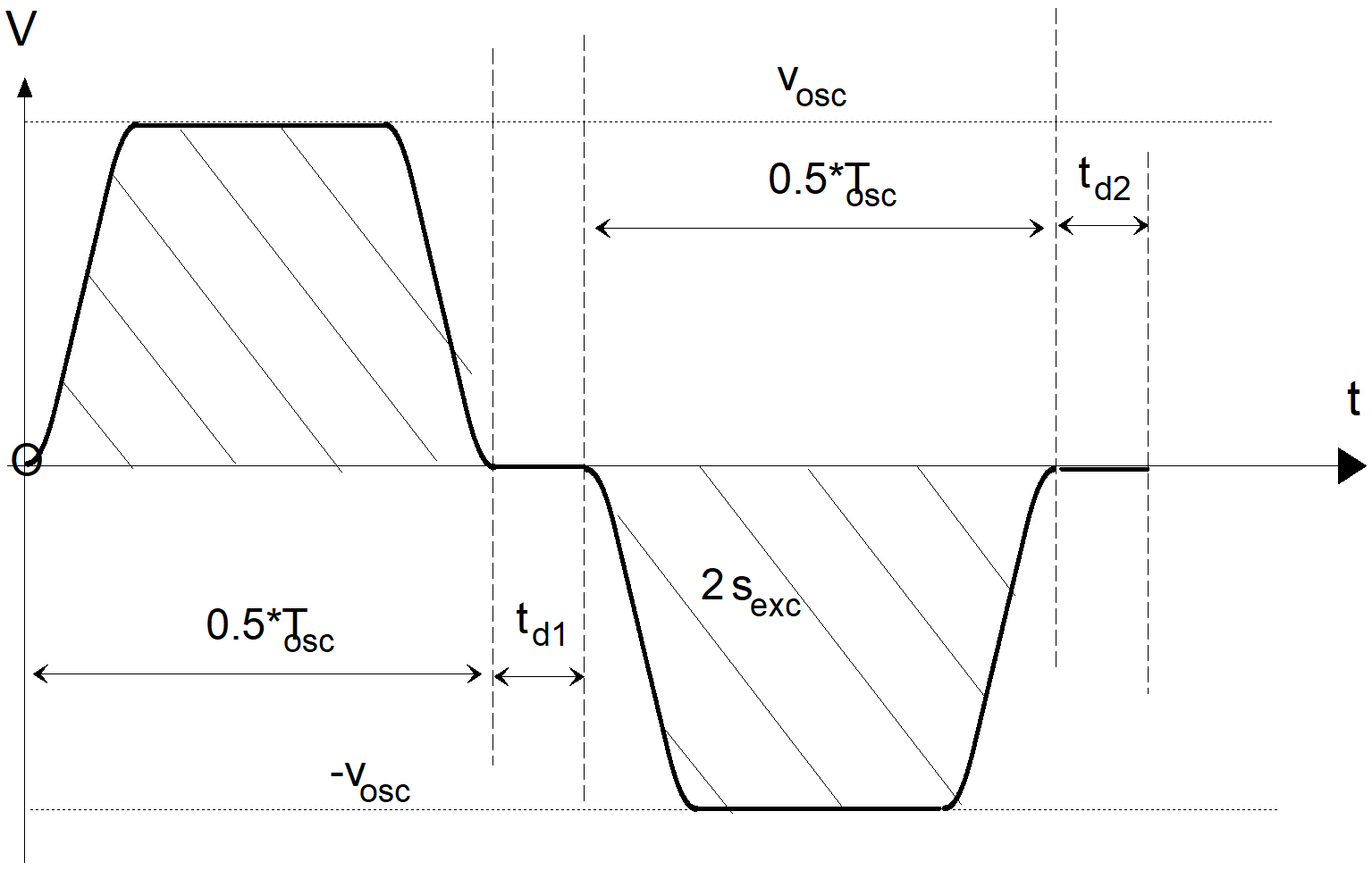

An oscillating motion can be described by the following parameters in addition to the profile type which defines the velocity curve in the dynamic phase.
vosc: | Oscillation feed |

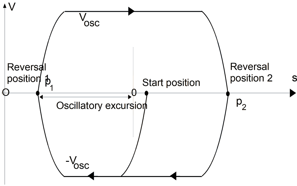

The time and path diagrams below explain the parameters:

- The essential characteristics of the oscillating motion result from the oscillating motion between two absolute positions as well as the feed rate.
- Any definition of the oscillating axis within the configured axes
- Asynchronous oscillating motion
- Alternative programming of the oscillating axis in the path compound
- The oscillating motion is started, stopped and parameterised via the NC program
- Slope type depending on the channel parameter settings
- Programmable waiting times at the reversal points of the oscillating motion
- Using G01 acceleration in the dynamic phases of the motion

![]() | After an oscillating motion is deactivated, the motion is always stopped at oscillating position 2. |
