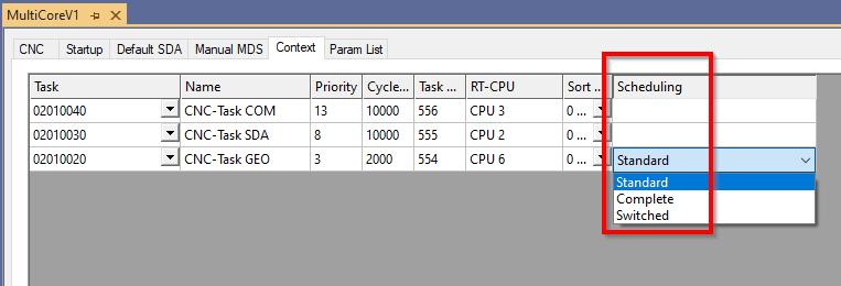

Configuration
In TwinCAT, the schedule is set in the "Context" tab of the "CNC" node:
