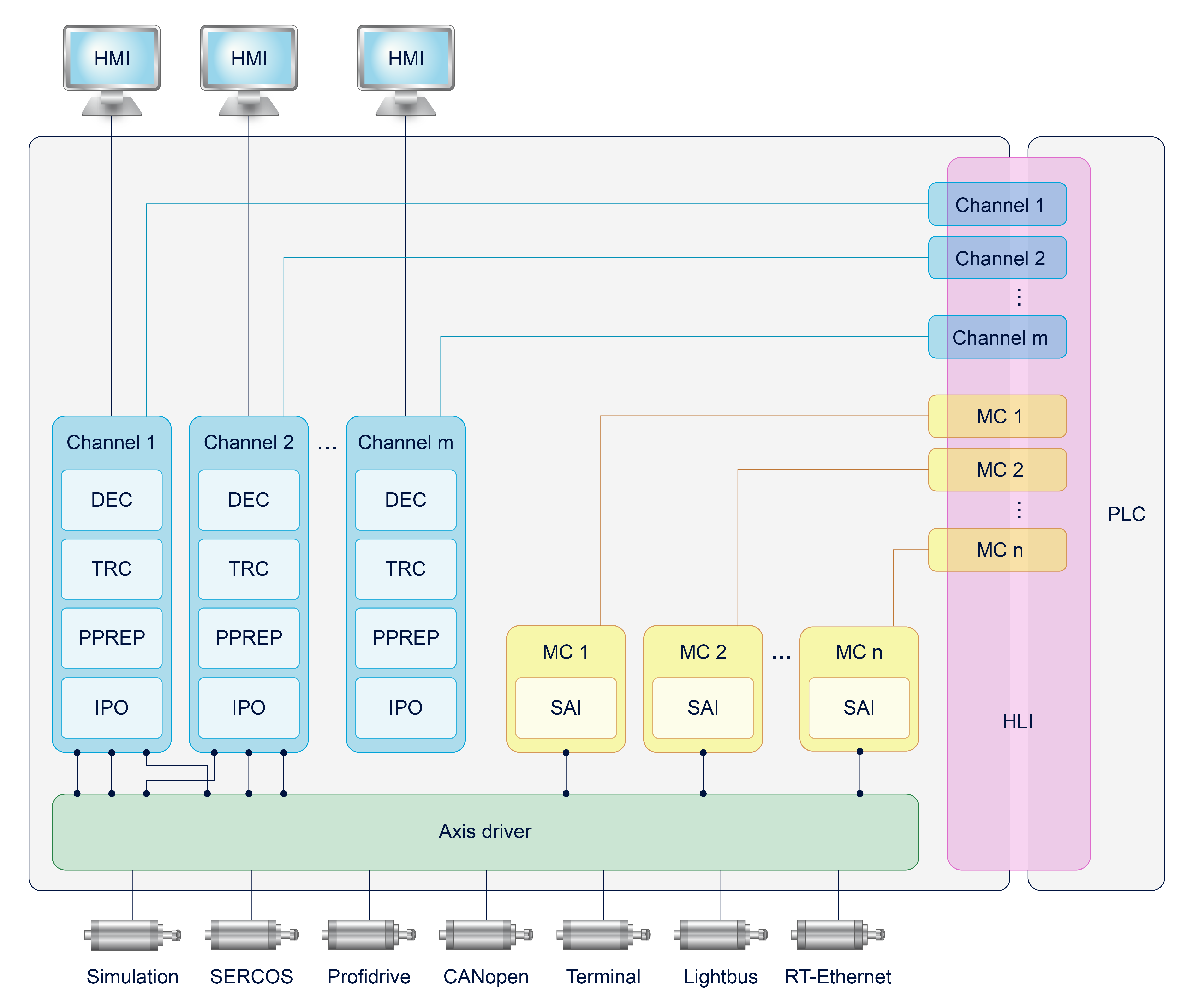

Structural description of a multi-channel CNC
A CNC can be designed for several NC channels with additional single-axis interpolators.
The processing of an NC program can be executed in each channel. A group of axes moved together is used for this.
A single-axis interpolator can move a single axis, e.g, by a PLC command.
Description 1:
Structure of a multi-channel CNC
HMI:
User interface
IPO:
Path interpolator
DEC:
Decoder
SAI:
Single-axis interpolator
TRC:
Tool radius compensation
MC:
Motion Control
PPREP:
Path preparation
