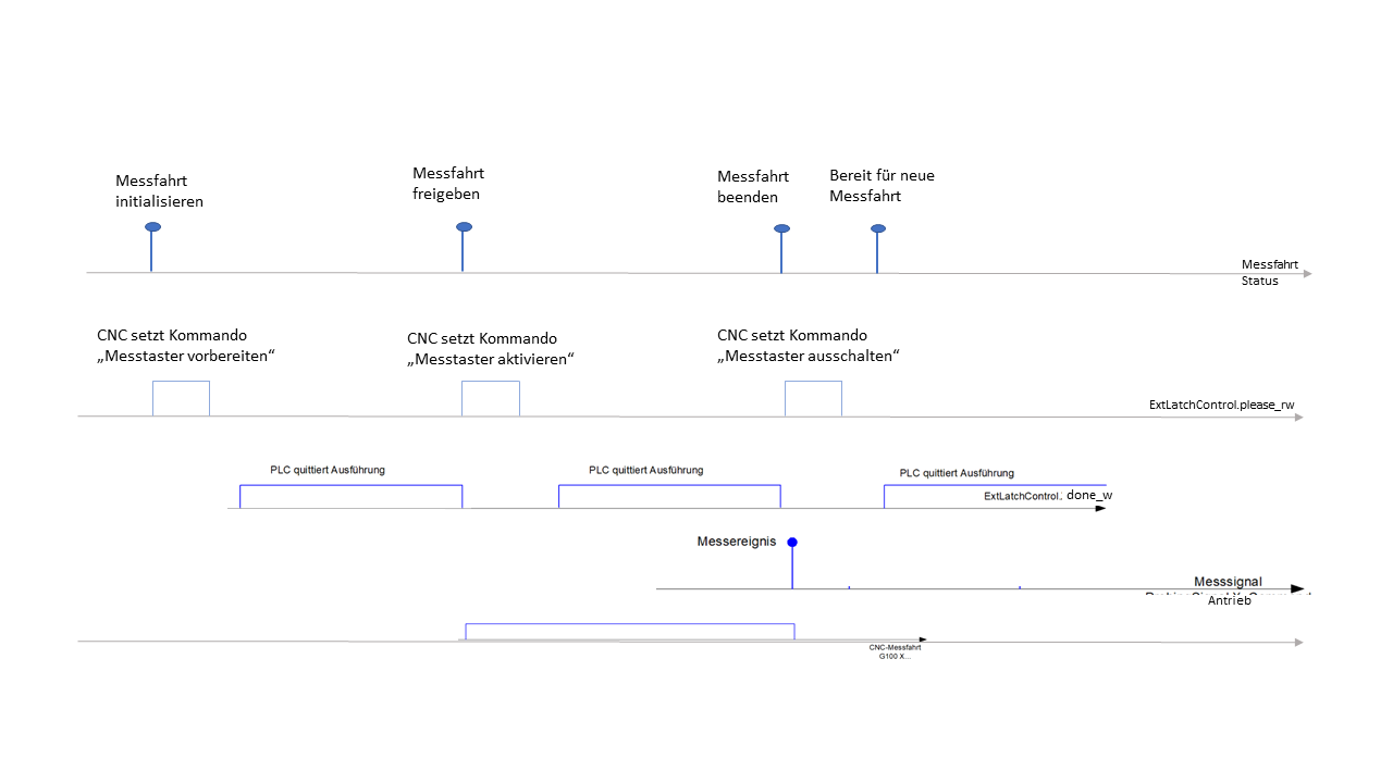

Probing with switchable probe and measured value detection in the drive 1:
Signal profile of the radio measuring button
Before a new measurement run starts, the system waits until the PLC acknowledges the task “HLI_EXT_LATCH_DISABLE_PROBE“.
For more information on the interface structure, refer to the HLI documentation. (see Measure with external measuring hardware).
