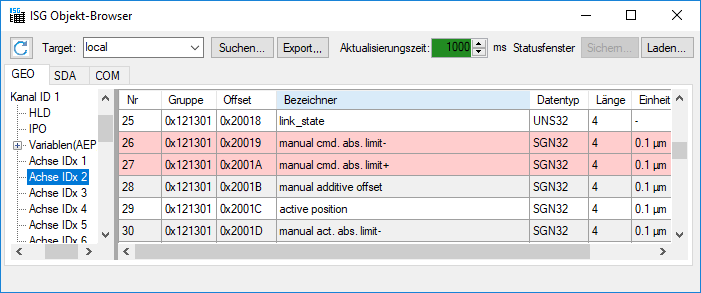

Verify absolute offset limits via the ISG object browser
