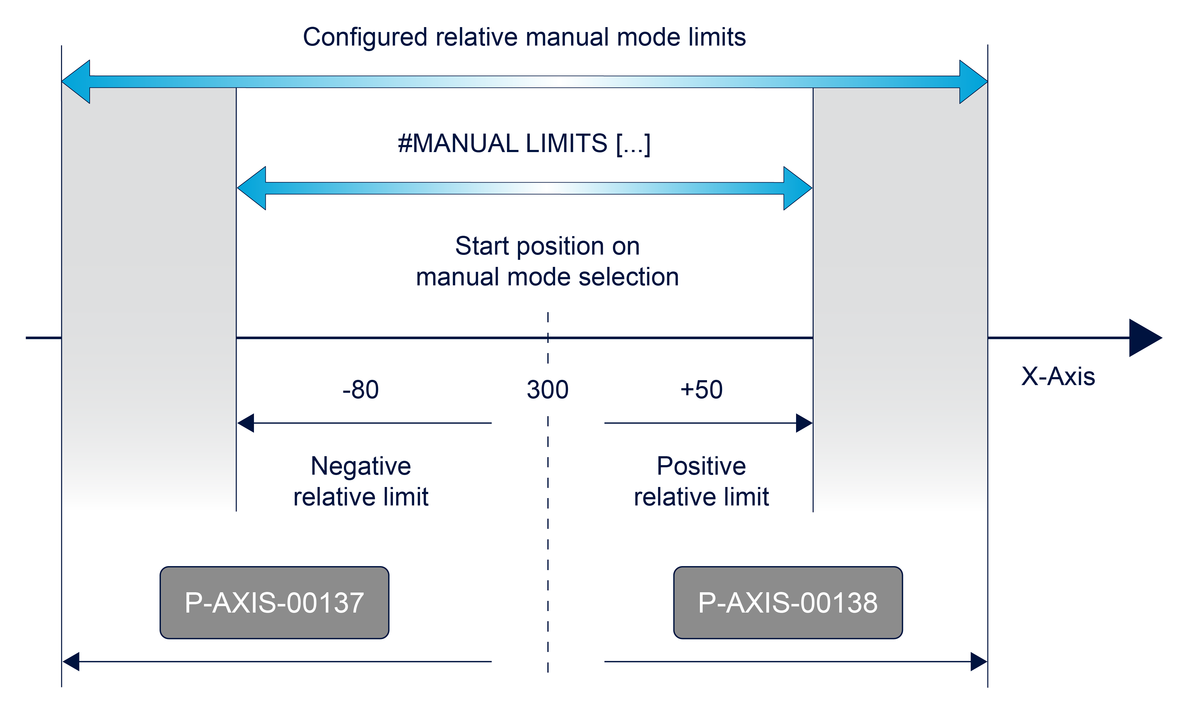

Relative offset limits
Definition
After HB is selected, offset limits act relative to the current axis position (start position) and are defined by:
- P-AXIS-00137 and P-AXIS-00138 or
- #MANUAL LIMITS[...]
Activate the monitor
To activate the relative offset limit monitor, at least one of the limits P-AXIS-00137 or P-AXIS-00138 must be configured with the value ≠ 0.
- 1. The monitor is activated.
![]() | If both limits = 0, the monitor is not active. |
