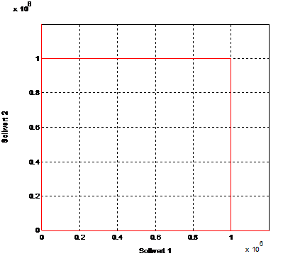

Example 1
In the test program below, a square with an edge length of 100 mm is moved. Each side is segmented into 100 single blocks. Based on a time ahead of 2 seconds, as values become increasingly smaller it becomes apparent that the contouring speed can no longer be kept constant due to the pulsating supply of blocks.

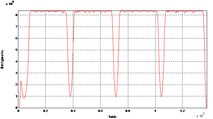

Programming examples 1:
Test path: Path velocity curve at different times ahead:
Programming examples 2:
Time ahead: 2 seconds, block supply is sufficient

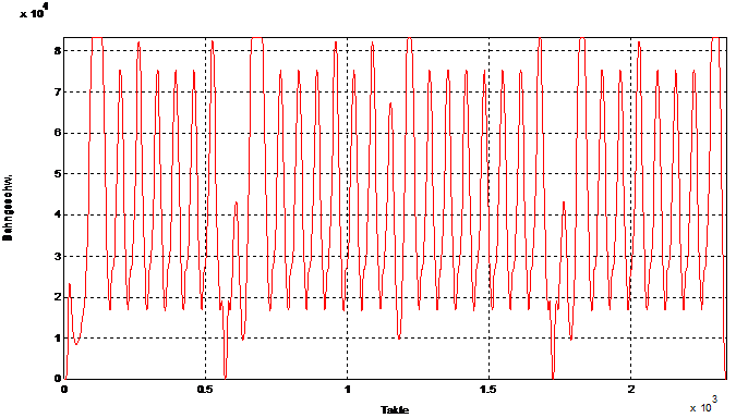

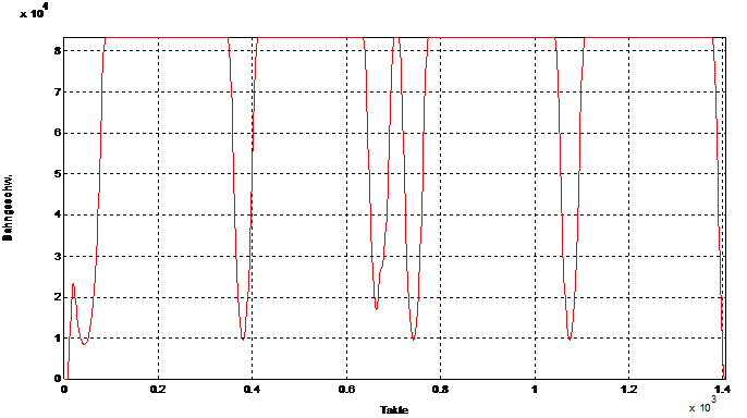

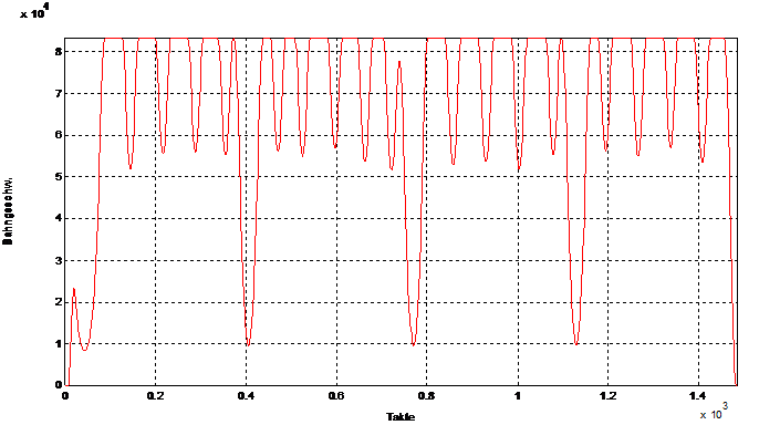

Programming examples 5:
Time ahead: 0.225 seconds, block supply starts to pulse, path velocity varies

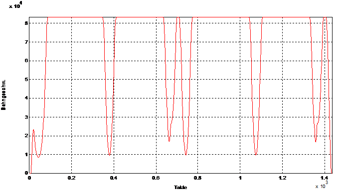

Programming examples 6:
Time ahead: 0.2 seconds, block supply pulses more strongly, path velocity varies

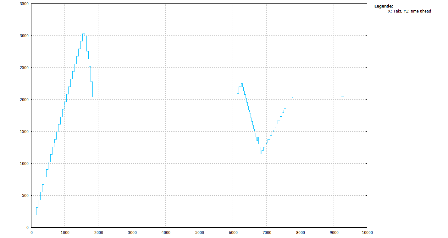

Test 1:
Program with 40 mm linear blocks and feed limits, time ahead 2s

Programming examples 8:
Block ahead limiting with no consideration given to average velocity (P-CHAN-00428 = 0, block lengths 40mm and active block ahead limits)
Block supply is ensured by the long geometry blocks (40mm). The velocity influence by #VECTOR LIMIT is not considered in the time ahead calculation due to P-CHAN-00428 = 0. The required time ahead of 2 s is exceeded by a considerable amount

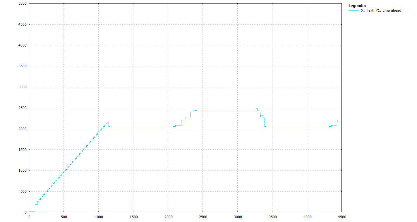

Programming examples 9:
Block ahead limiting with no consideration given to average velocity (default or P-CHAN-00428 = 1, block lengths 40mm and active feed limits)
At start a slight excess occurs but this is re-adjusted. The required time ahead of 2 s is basically maintained

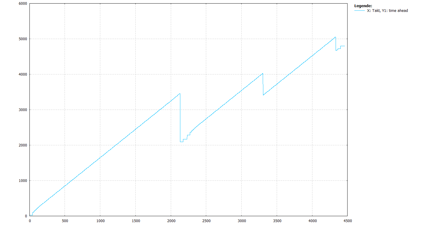

Test 2:
Program with 10 mm (short) linear blocks and feed limits, time ahead 2s

Programming examples 10:
Block ahead limiting with no consideration given to average velocity (P-CHAN-00428 = 0, block lengths 10mm and active block ahead limits)
Due to the short geometry blocks (10mm) the priority for interpolation is to ensure block supply. Stable block ahead limiting is not achieved. The required time ahead of 2 s is exceeded by a considerable amount.

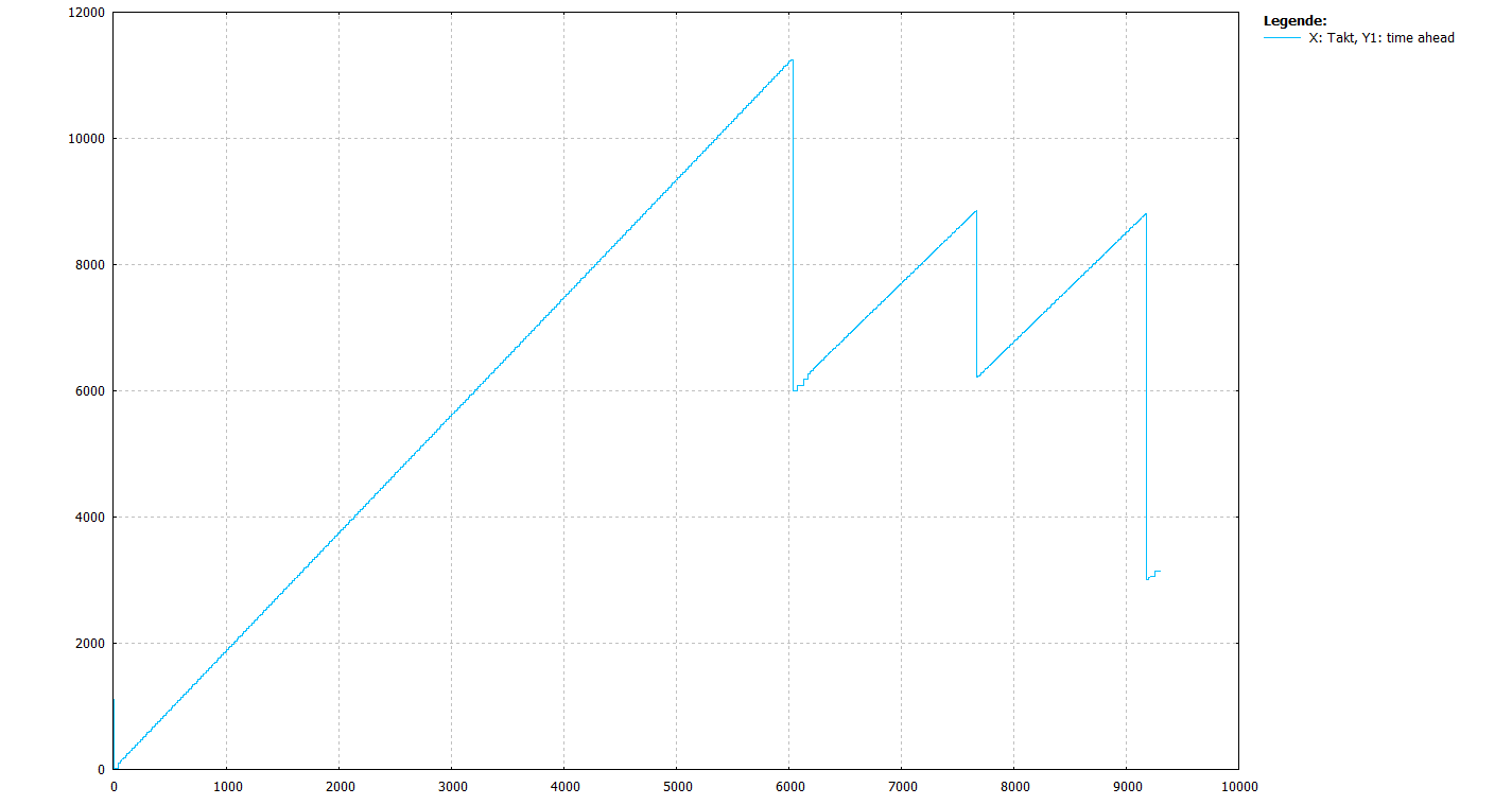

The graphics below show the curve of time ahead in an actual program. It features strongly fluctuating feeds (rapid traverse and normal feed). The resulting deceleration and acceleration phases cannot be exactly considered in advance when estimating block ahead limiting. This then results in a more or less strong deviation in the programmed time ahead.

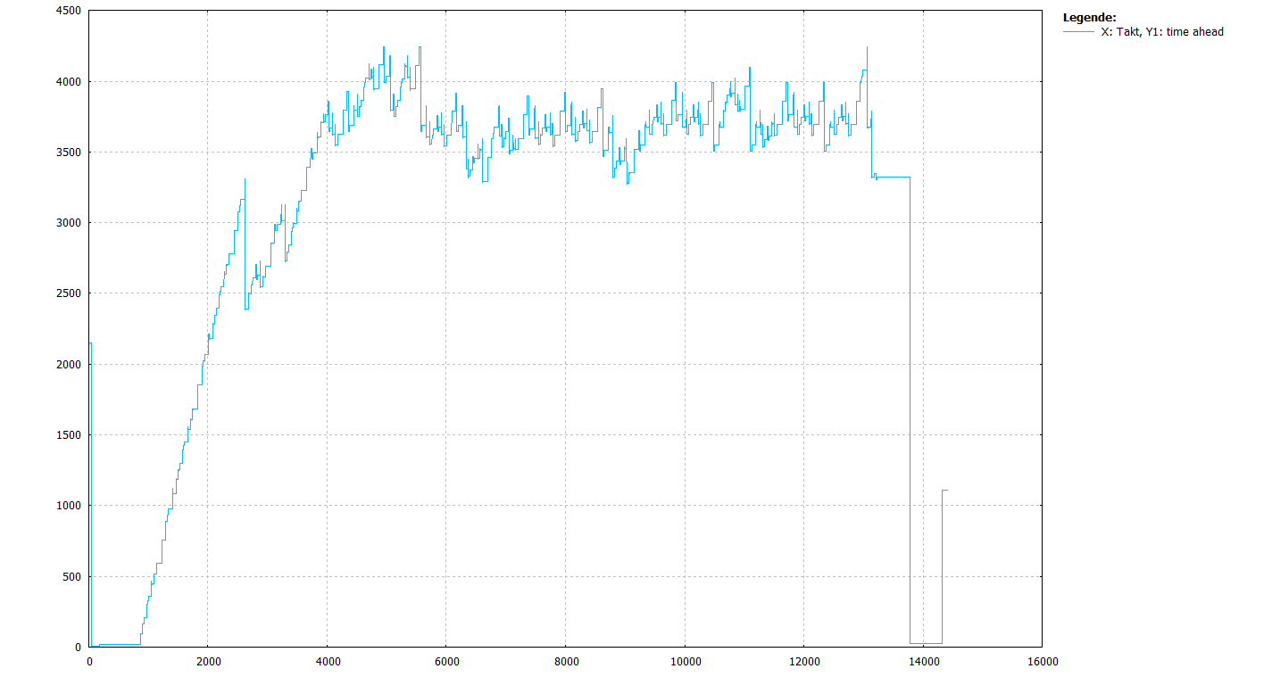

Test 1:
Programming examples 14:
Block ahead limiting with no consideration given to average velocity (P-CHAN-00428 = 0), block supply is insufficient due to the very high feed, time ahead at 7s to 8s

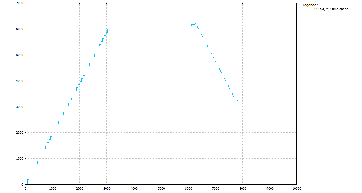

Test 2:
Programming examples 15:
Block ahead limiting with consideration given to average velocity (default or P-CHAN-00428 = 1), block supply sufficient, system can settle. Much improved time ahead between 3s and 4s
