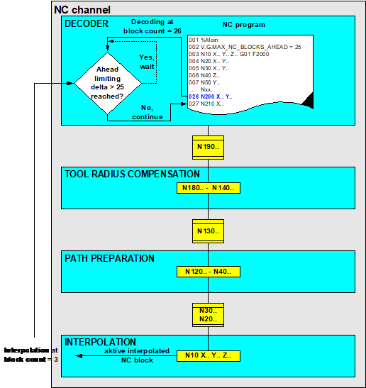

For every NC block output, the decoder saves the associated block count and an associated output count in an internal table.
During the program run, the decoder determines the related delta of the output count (block ahead) using the block count signalled by the interpolator.
If this delta is greater than the permitted defined limit, the decoder interrupts processing. Before continuing the decoding function, the decoder waits until the interpolator again undershoots the defined limit, i.e. it catches up.
Block ahead limiting on the basis of the number of blocks 1:
Checking the decoder/interpolator block ahead limit function
In the figure the delta of the block ahead limit is 26-3 = 23, i.e. decoding is continued since the block ahead limit of 25 is not yet reached.
