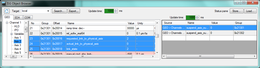

The current state of an axis can be read by the following channel-specific CNC objects of the axis.
In the example below, channel 1 is waiting for the acknowledgement of the request for the second axis. This can be seen by the CNC object “link_state” which has the value 2.
The command value suppression is not active in either channel.
HMI interface 1:
Waiting for axis acknowledgement.
