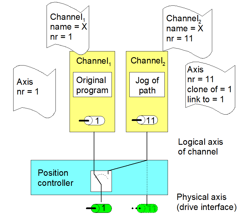

In order to interrupt a machining process and move an axis by another channel, an additional logical axis (e.g. Log. AchsNr. 11) is configured and linked to an existing physical axis (e.g. Log. AchsNr. 1). The link is specified in the axis parameter kopf.link_to (P-AXIS-00101).

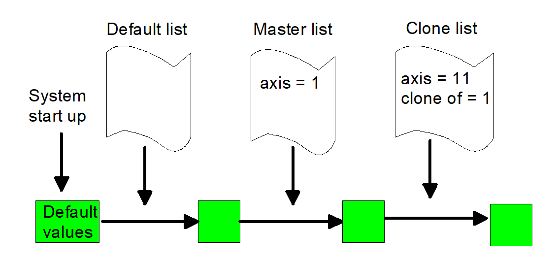

A clone operation takes over all data from the original axis except for the new axis number. This is executed by the axis parameter kopf.clone_of (P-AXIS-00040) by specifying the axis number of the axis whose axis parameter list is to be copied.
kopf.achs_nr                      11
kopf.link_to                      1
kopf.clone_of                     1

Channel 2 represents the jog-of-path channel and contains axes 11 to 13 as main axes
gruppe[0].achs_anzahl             3
gruppe[0].achse[0].log_achs_nr    11
gruppe[0].achse[0].bezeichnung    X
gruppe[0].achse[1].log_achs_nr    12
gruppe[0].achse[1].bezeichnung    Y
gruppe[0].achse[2].log_achs_nr    13
gruppe[0].achse[2].bezeichnung    Z
The parameter P-CHAN-00306 is set in the jog-of-path channel for checking the license.
jog_of_path_only                  1

To create a cloned axis, the axis must first already exist and be initialised before its axis parameter list can be used as a template for the cloned axis. A cloning process involves taking over the parameters of the axis which acts as a template only once. Any subsequent change in axis parameters has no effect on the cloned data set. It only modifies or overwrites the individual axis parameters.

Initialising a cloned axis
The specified clone reference cannot be changed after the first initialisation.
If the clone has no master axis, the error messages ID 70172 and ID 50462 are output and a cloned axis is created without a real cloning process.
