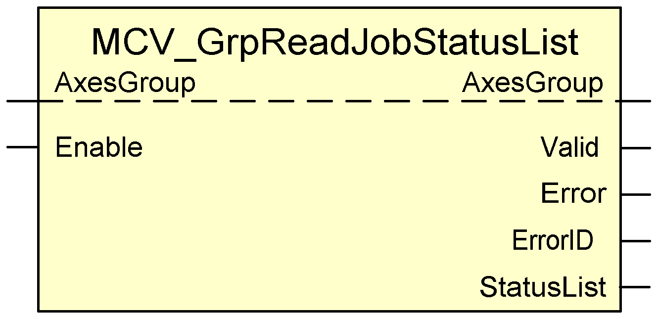

The function block is used to display the states of all jobs currently commanded for an axis group.
Block diagram
FB parameters
VAR_IN_OUT | ||
Variable name | Data type | Description |
AxesGroup | AXES_GROUP_REF | Axis group reference |
VAR_INPUT | ||
Enable | BOOL | If the input is TRUE, the function block outputs are updated. |
VAR_OUTPUT | ||
Valid | BOOL | TRUE indicates that the requested update was executed. |
Error | BOOL | TRUE indicates that an error occurred. |
ErrorID | WORD | Error code |
StatusList | MCV_GRP_JOB_DISPLAY | Structure that describes the states of all current MC_MovePath commands in a channel. |
