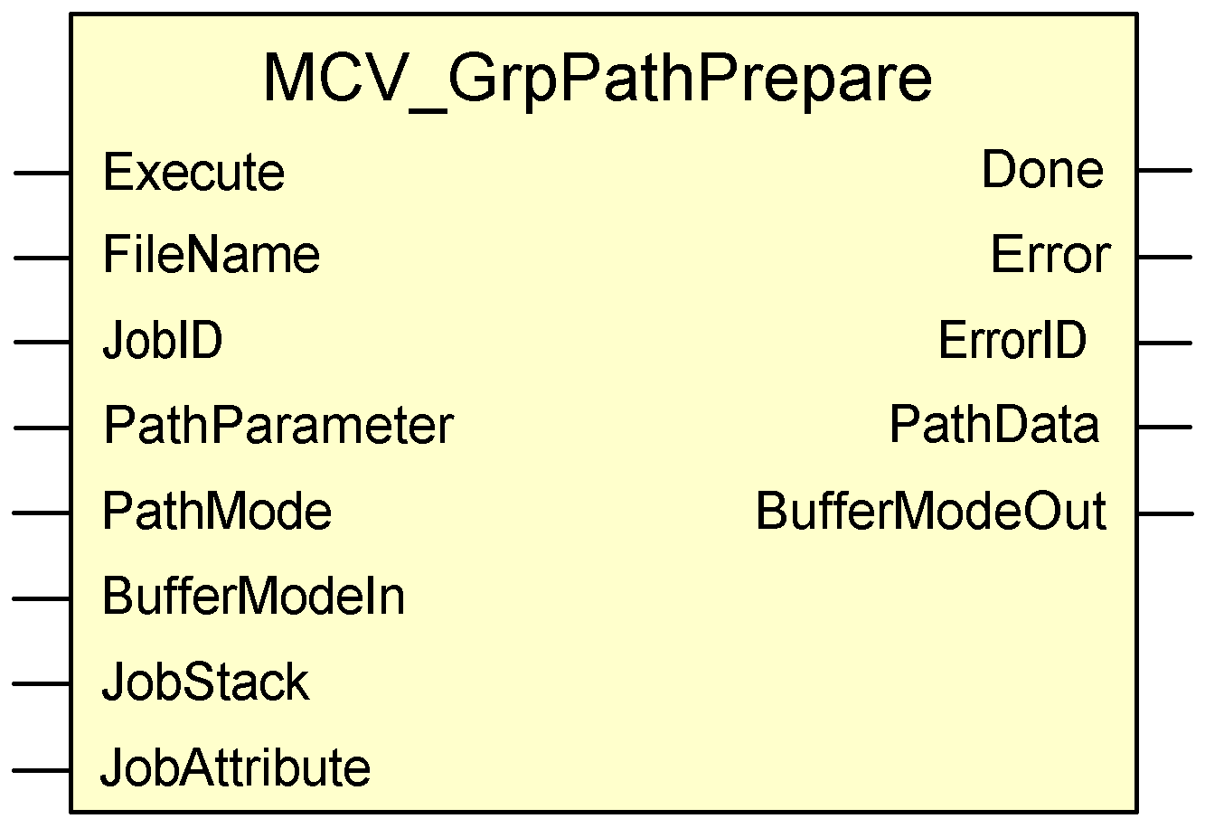

Block diagram
MCV_GrpPathPrepare 1:
FB parameters
Variable name
Data type
Execute
The function block is executed on a rising edge at the input.
FileName
STRING(MCV_PROG_NAME­_STRLEN)
Program name of a job.
JobID
MCV_GRP_JOB_ID
Job information
PathParameter
MCV_PATH_PARAM
Program parameters of a job.
Parameters can be accessed in the called NC program (FileName). PL[0] corresponds to the variable @PL1 and PL[19] corresponds to the variable @PL20. Unused parameters are prefixed by “0”.
PathMode
MCV_PATH_MODE
Parameter for program mode of a job. The following are available:
- InitializeOnActualPosition,
- SetDefaultConfig,
- ReportSceneSample,
- ReportRunTimeMeasure,
- ReportAxesPositionSample where
0 = HLI_MC_START_MODE_NOT_USED
1 = HLI_MC_START_MODE_OFF
2 = HLI_MC_START_MODE_ON
3 = HLI_MC_START_MODE_USE_ACTUAL
BufferModeIn
MC_BUFFERMODE
BufferMode of a job.
The following values (similar to the BufferMode interface in the MC_MovePath) are possible:
mcAborting= 0
mcBuffered= 1
mcBlendingPrev= 3
JobStack
HLI_MC_JOB_STACK
Information on the job source Only needed if the job was read in by an instance of the MCV_GrpGetJobRequest. Otherwise, the input must remain unassigned.
JobAttribute
UDINT
Identification number which is freely assignable by the user.
Variable name
Data type
Done
TRUE indicates that the data structure MC_PATH_DATA_REF was correctly filled out and can be transferred together with the value of the "BufferModeOut” output to an instance of the MC_MovePath function block.
Error
TRUE indicates that an error occurred.
ErrorID
WORD
Error code
PathData
MC_PATH_DATA_REF
Structure for use at the “PathData” input of an instance of the MC_MovePath.
BufferModeOut
MC_BUFFERMODE
BufferMode for use at the “BufferMode” input of an instance of the MC_MovePath function block.
