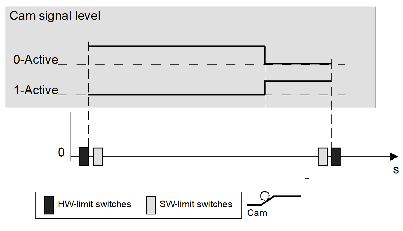

Cam switch signal level
The level when the cam switch is operated can be either logic 0 (0-active) or 1 (1-active). The sequence parameter P-AXIS-00038 (cam_level) sets the level.
0: 0-active
1: 1-active
Cam switch signal level 1:
Cam signal level
