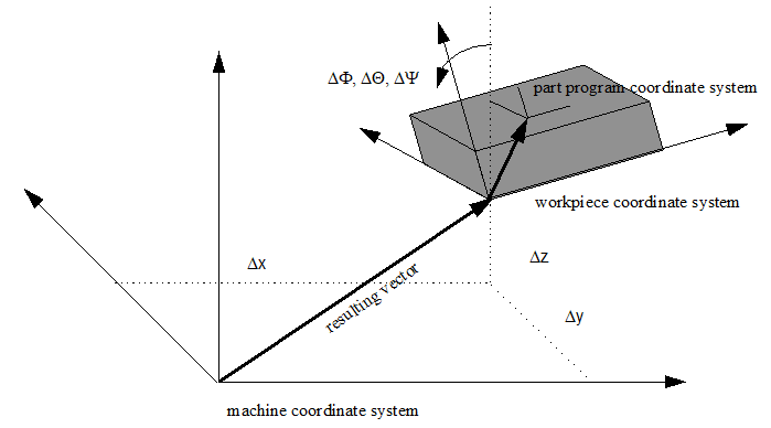

Definition of coordinate systems 1:
Coordinate systems
Consequently, data or variables described below always refer to a specific coordinate system. Three coordinate systems are shown in the figure above. The offsets depicted Δx, Δy and Δz and the orientations ΔΦ, ΔΘ and ΔΨ represent the transformation parameters from mcs to wcs. The orientation angles are Euler angles.

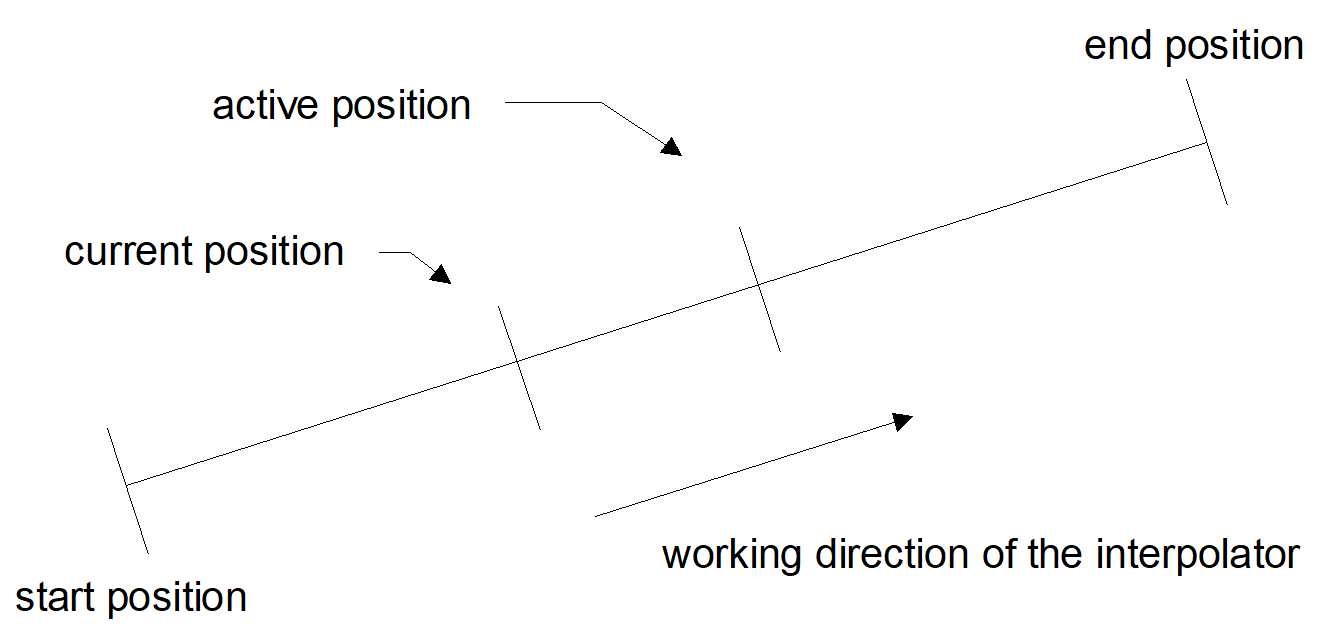

Naming must be supplemented by means of an additional suffix in order to allow for the time aspect. The figure below shows the machining direction of a machining block. The end position represents the programmed value; the active position is the current value of the interpolator; and the current position is the actual position including the control error.
Definition of coordinate systems 2:
Position values in PC and AC
