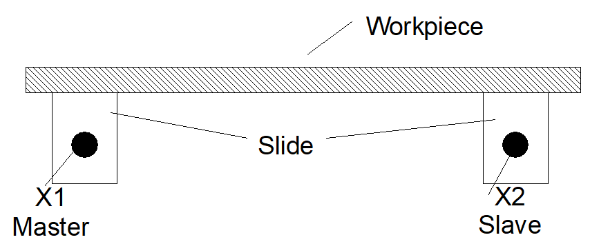

Soft gantry (programmable)
Machines that require no mechanical gantry mode due to their basic structure, for example milling machines with two independent slides, can be run by programming them in gantry mode. For example, this is necessary when slides must be linked to one another for clamping and machining large workpieces (see figure below).
