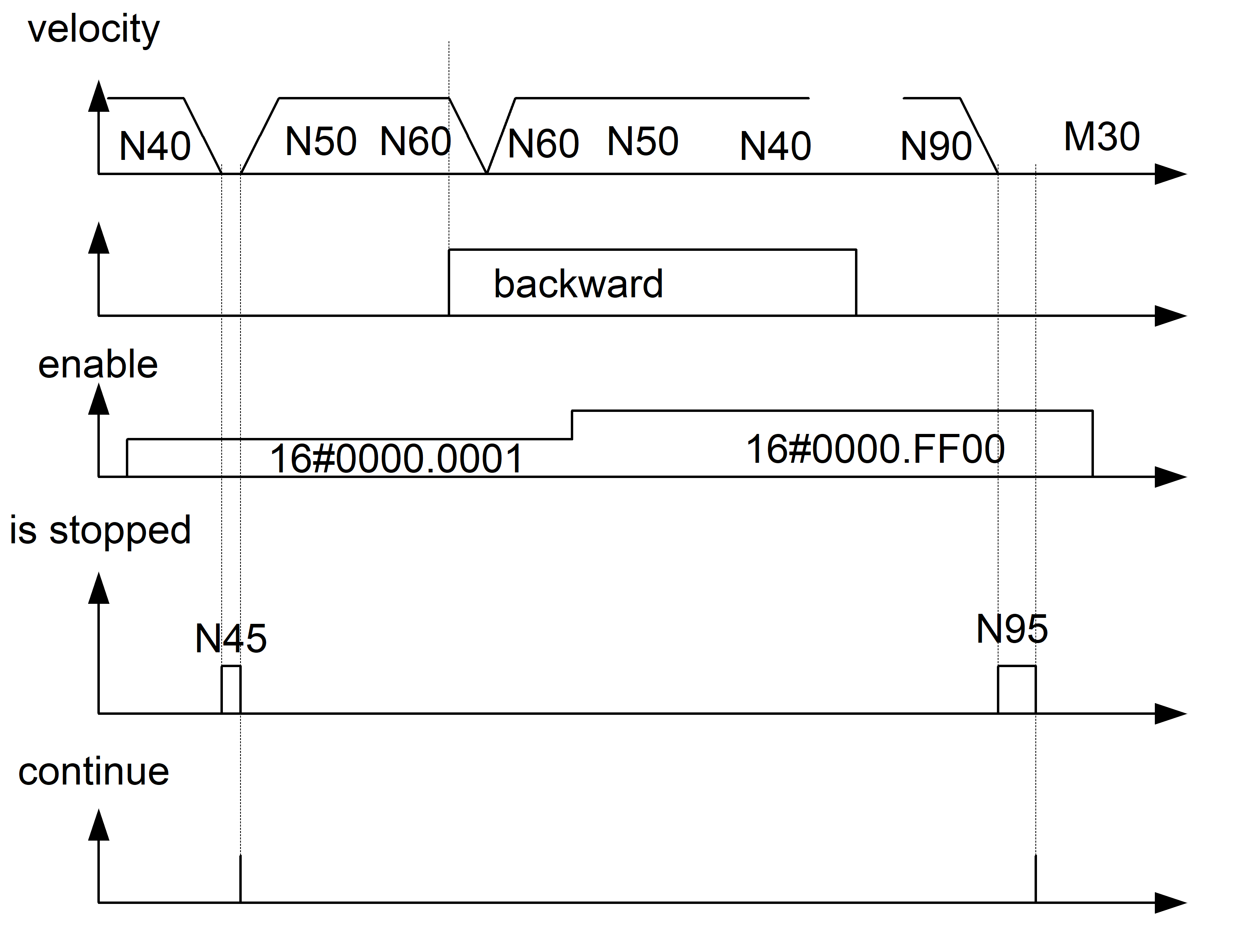

Example 4: Enabling the programmed STOP by the PLC
The stop condition N45 is suppressed in the backward direction since the LEVEL bit = 16#1 is not set for the motion.

Example 4: Enabling the programmed STOP by the PLC 1:
