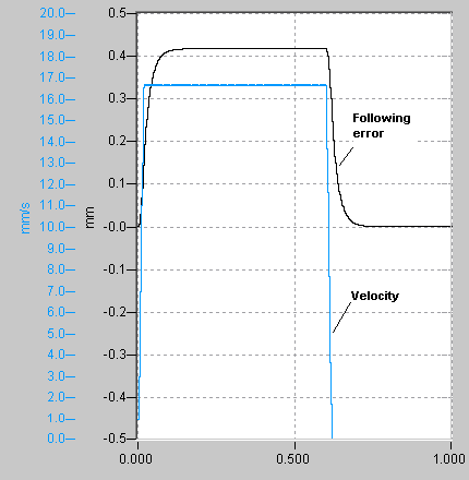

The figures below show the measured position lags with and without speed and acceleration feedforward control for a simple path motion.
The figure below shows a clear position lag over the entire path motion.
Programming 1:
Position lag without feedforward control

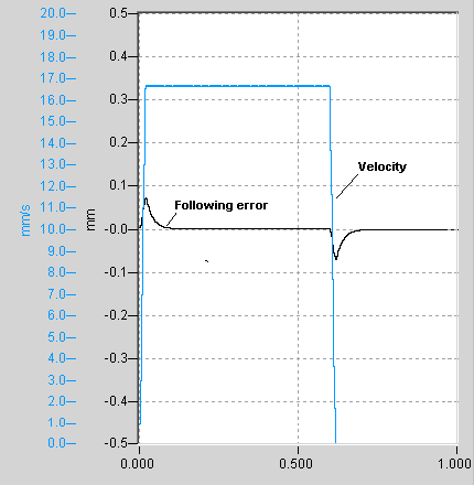

When speed feedforward control is activated, position lag peaks only occur in acceleration phases. Within the constant speed range, position lag is fully compensated by feedforward control (see figure below).
Programming 2:
Position lag with speed feedforward control

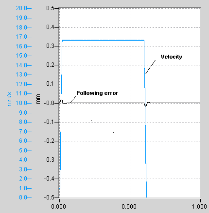

Programming 3:
Position lag with speed and acceleration feedforward control
