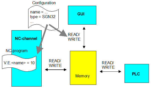

External variables describe a data memory which is used to exchange any values between the CNC (NC channel), the graphic user interface (GUI) and the PLC. Data can be used within the CNC either channel-specific (only accessible by one channel) or cross-channel (“global”). The meaning of the individual memory locations (here an external variable) is defined by the application (NC program, GUI and PLC).
The CNC itself only has the task of defining the memory layout and allowing the user access to the variables in the NC program. During the configuration phase, a name, a type and an access right (write and/or read) are assigned to each external variable. Optionally, memory addresses and variable size can be assigned by the user.
It is recommended to use the automated address assignment by the CNC to avoid problems caused by alignment or memory overlaps. A combination of the two address assignments is possible but this is also not recommended.

A memory description is required to permit the GUI or a PLC to access the memory layout correctly - ultimately, this is defined by the CNC. This is made possible by the command #EXPORT VE. It is recommended to execute this command before the first start of the PLC. The command generates declaration files which can be directly integrated in the PLC programming environment. This obviates the need for an extremely (!) error-prone manual simulation of the memory layout by the GUI or PLC.
Notice | |
If addresses and types are not identical between the CNC and the PLC or GUI variables, the CNC has no possibility of checking this or preventing an error response. |
