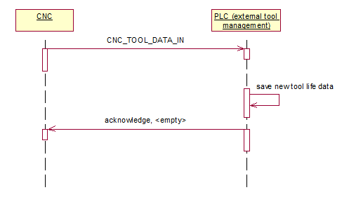

With every programmed T<i> or #TOOL PREP and if P-CHAN-00076 is set, the complete tool ID, tool life time and tool life distance are sent automatically by the CNC to the PLC.
The transferred data can be saved and further processed in the PLC. The PLC must acknowledge receipt by returning a blank message.
The following data is transferred by the CNC to the PLC:
CNC_TOOL_DATA_IN | (Tool life data sent from CNC) | |
tool_id | : CNC_TOOL_ID; (Tool id from CNC) | |
time_used | : LREAL; (Usage time of tool in seconds) | |
dist_used | : LREAL; (Usage distance in mm) | |
