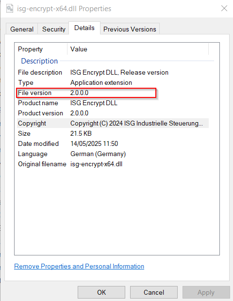

Version number
The file version of the dll can be determined with the library method get_version(). This is the same version that is obtainable by right-clicking File => Properties => Details (see the figure below).
Version number 1:
Determining the dll file version
