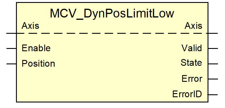

MCV_DynPosLimitLow
If an axis position should be prevented from undershooting a specific value, this function block specifies the limit that may not be undershot. If the axis moves towards the limit, the motion is controlled so that the axis stops within the limit range. The position limit may be crossed by the distance which is travelled in one controller cycle.
Block diagram
MCV_DynPosLimitLow 1:
FB parameters
Variable name
Data type
Axis
AXIS_REF
Axis reference
Variable name
Data type
Enable
If TRUE, the position limit is written to the PLC interface (HLI).
Position
DINT
Position limit specification
Variable name
Data type
Valid
Is TRUE when specified set value is activated.
State
DINT
Current position limit
Error
Indicates whether an error has occurred in an FB.
ErrorID
WORD
Error identifier
