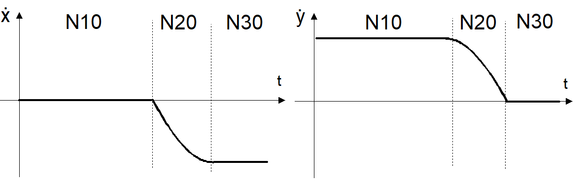

Path profile with tangential continuous block transitions

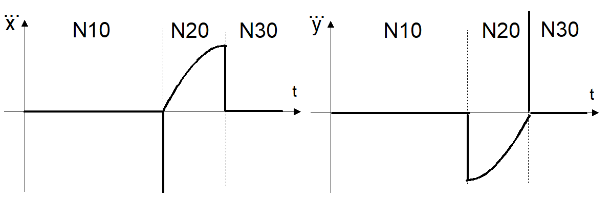

A jerk in axis acceleration occurs
with tangential continuous block transitions. This is linked to a relatively large axis jerk even if the path velocity is constant. Below are several examples showing velocity, acceleration and jerk in the axes:
Example

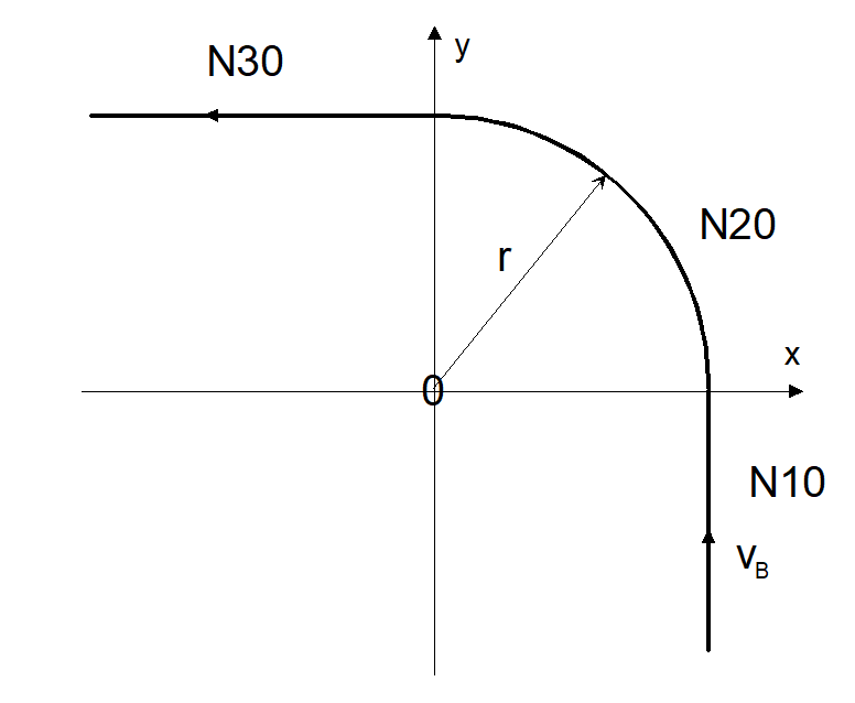

Block transition linear block -> circular block
Path profile with tangential continuous block transitions 1:
Tangential continuous block transition from linear block to circular block

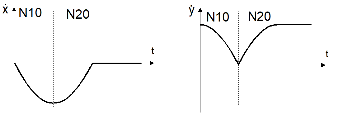

Path profile with tangential continuous block transitions 2:
Velocity profile on X and Y axes

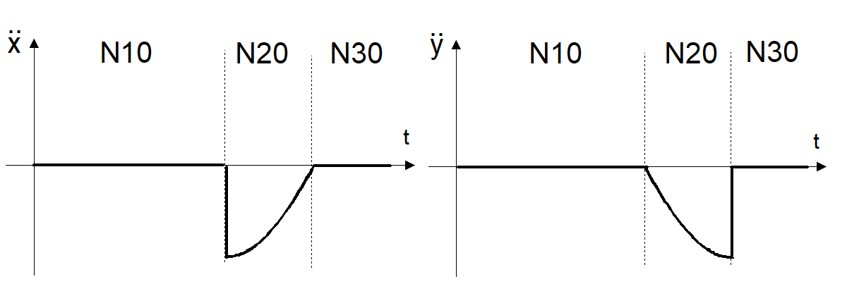

Path profile with tangential continuous block transitions 3:

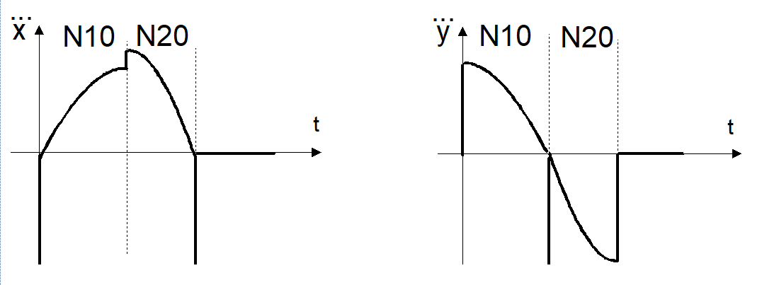

Acceleration profile on X and Y axes
Path profile with tangential continuous block transitions 4:
Jerk profile on X and Y axes

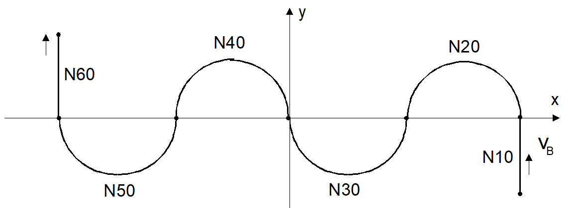

Example
2. Block transition circular block -> circular block with change in direction of rotation G03 -> G02
Path profile with tangential continuous block transitions 5:
Tangential continuous block transition from circular block to circular block

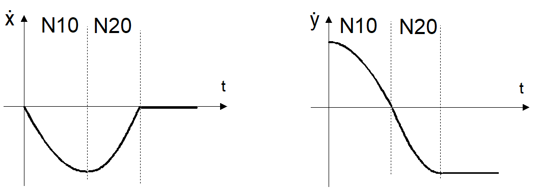

Path profile with tangential continuous block transitions 6:

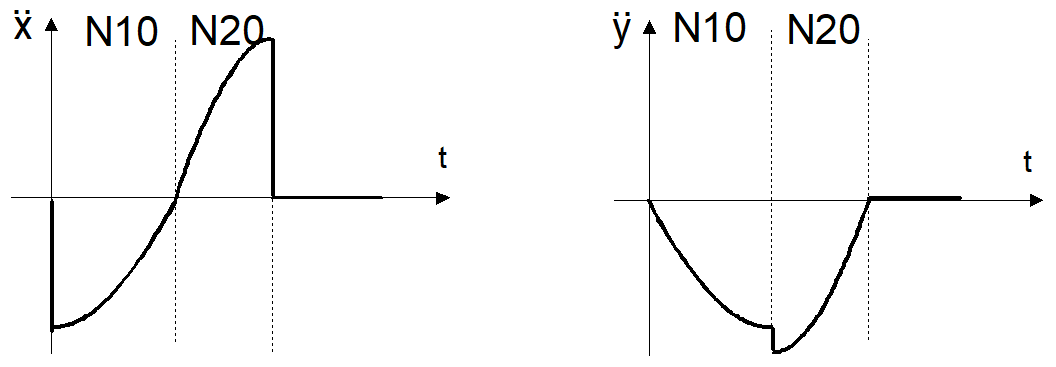

Path profile with tangential continuous block transitions 7:

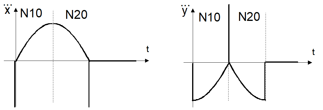

Path profile with tangential continuous block transitions 8:

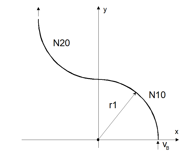

Example

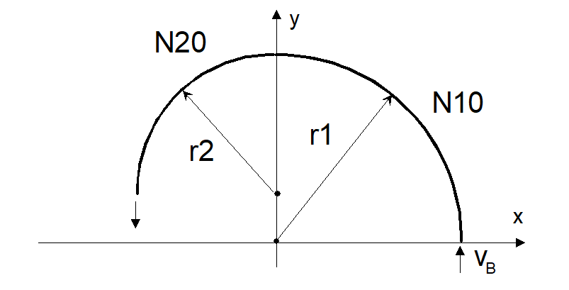

3. Block transition circular block -> circular block with radius change r2 != r1
Path profile with tangential continuous block transitions 9:
Tangential continuous block transition from circular block to circular block with radius change
Path profile with tangential continuous block transitions 10:
Path profile with tangential continuous block transitions 11:

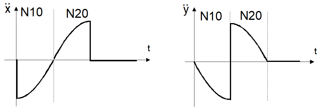

Path profile with tangential continuous block transitions 12:

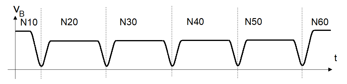

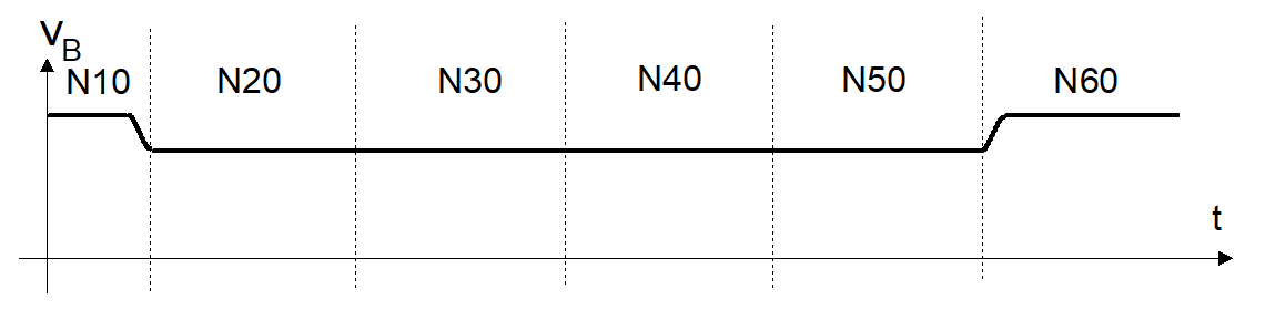

The figure below shows the influence of jerk limitation on the path velocity profile for a tangential continuous path with linear and circular blocks. It is assumed that the path velocity inside the circle is reduced due to the permissible axis acceleration values.
Path profile with tangential continuous block transitions 13:
Path velocity profile
Path profile with tangential continuous block transitions 14:
without jerk limitation at block transition
Path profile with tangential continuous block transitions 15:
with jerk limitation at block transition

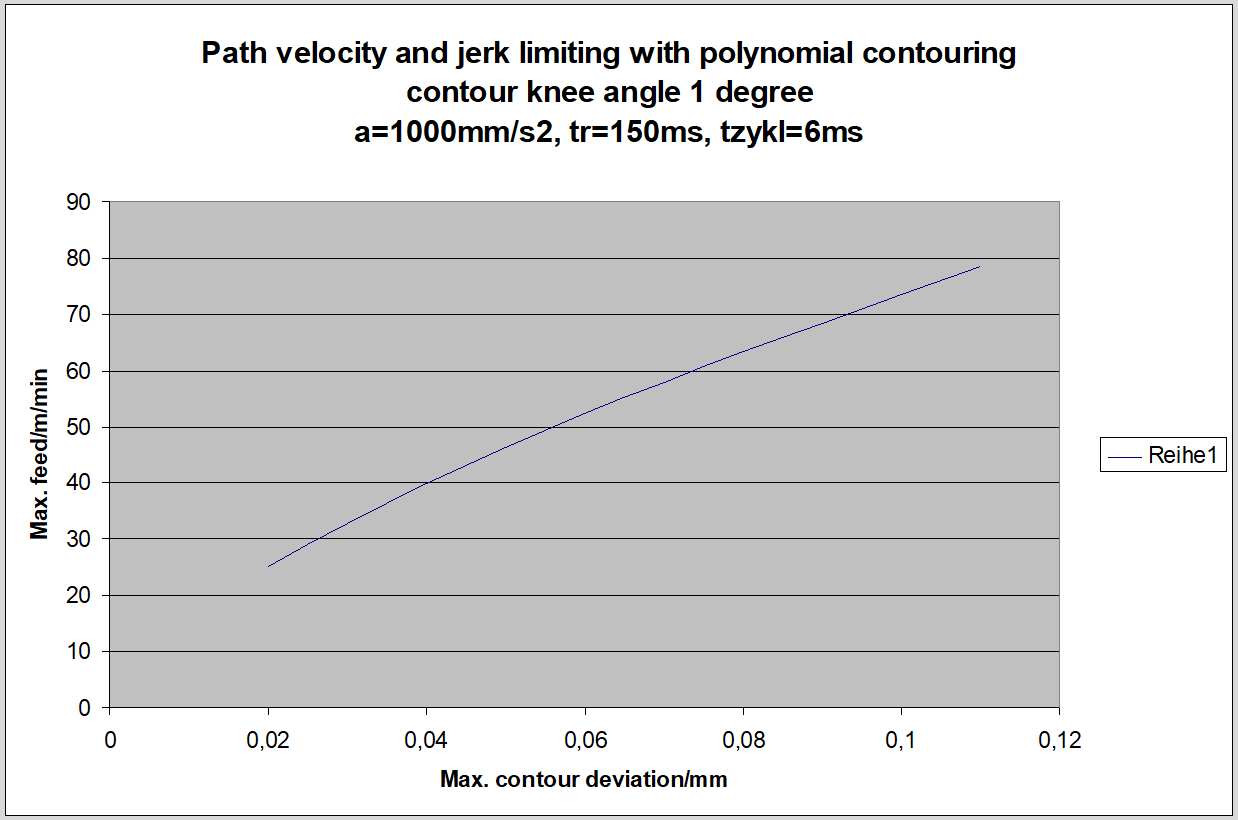

If a nominal path deviation is permitted, it is generally possible to move at a higher block transition velocity at path knees or tangential continuous transitions with activated jerk limitation by using path-influencing processes, e.g. polynomial contouring.
As indicated in the note, the diagram below shows a non-tangential continuous block transition with a knee angle of 1°. As opposed to a block transition velocity without contouring, it is possible here to move at a relatively high path velocity at the block transition in the event of a relatively small path error.
Path profile with tangential continuous block transitions 16:
Path velocity due to jerk limitation with transition polynomial
