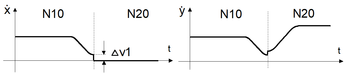

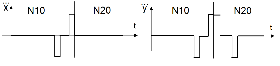

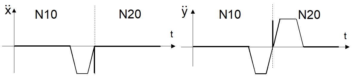

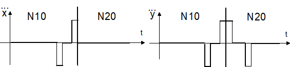

Path profile with non-tangential continuous block limits
Axis acceleration jerks occur at non-tangential continuous block transitions of paths, e.g. linear blocks with a prismatic workpiece. This results in very pronounced axis jerks if the path velocity is not reduced to 0 at the block transition.
Nevertheless, the controller ensures that acceleration jerks remain below the maximum acceleration of the affected axes.
This response is shown below by the example of a 45° knee angle in the velocity, acceleration and jerk profiles between two linear axes.
Path profile with non-tangential continuous block limits 1:
Path profile with non-tangential continuous block limits 2:
Path profile with non-tangential continuous block limits 3:
Path profile with non-tangential continuous block limits 4:

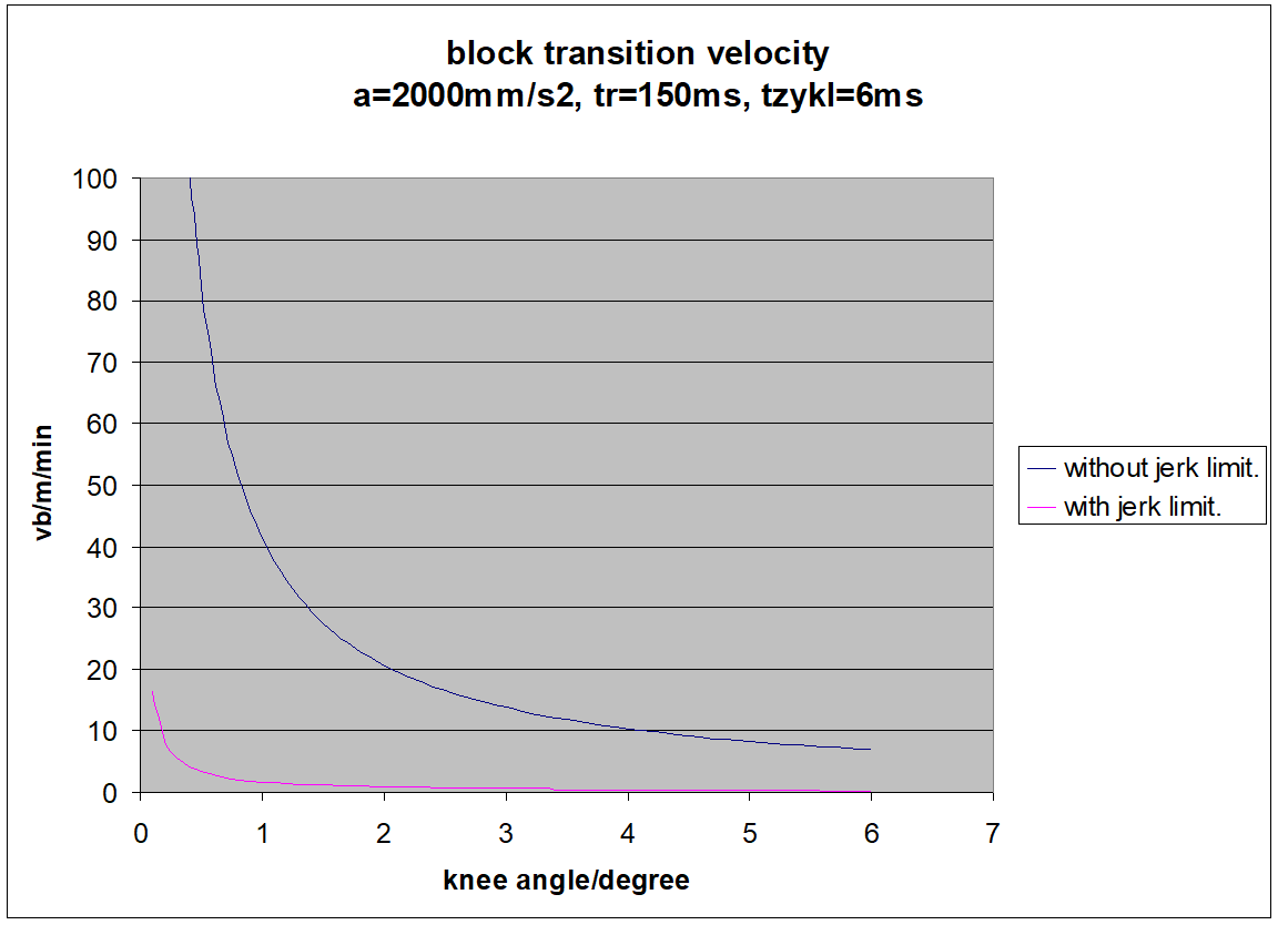

The figure below illustrates the influence of jerk limitation when P-AXIS-00013 = 0 on the block transition velocity between two non-tangential continuous motion blocks and different knee angles.
Path profile with non-tangential continuous block limits 5:
Influence of jerk limitation on block transition velocity
