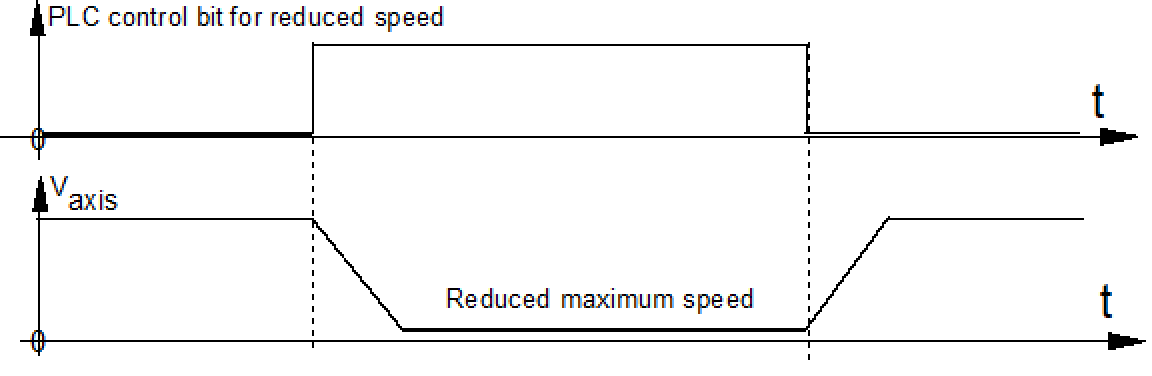

Reduced velocity with G01, G02, G03 P-AXIS-00214 and G00 P-AXIS-00155
The CNC takes these maximum velocity values into account after activation by a PLC control signal. This permits motion at reduced velocity, for example when guard doors are open.
Further limits 1:
Reduced maximum velocity
Reduced velocity in safety zone P-AXIS-00030
The CNC takes this maximum velocity value into account after activation by a PLC control signal whenever the axis is within a specific position range. This permits motion at reduced velocity, for example within a safety zone.
