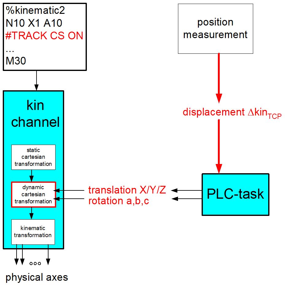

Example 2: Fluctuations in a kinematics base
Pure offsets in the base can also be compensated in the PCK tool centre point by an inverse offset. However, if rotations are added, compensation is no longer possible.
The CNC can compensate this by correcting the target position (green). In this case, the programmed target point is approached as if there were no errors in the base.
Example 2: Fluctuations in a kinematics base 1:
Example 2: Fluctuations in a kinematics base 2:
Structure with error compensation
The deviation of a kinematic base is measured. This is then considered by the dynamic coordinate system when the kinematic TCP is positioned to compensate for errors.
Example 2: Fluctuations in a kinematics base 3:
Determine fluctuations
