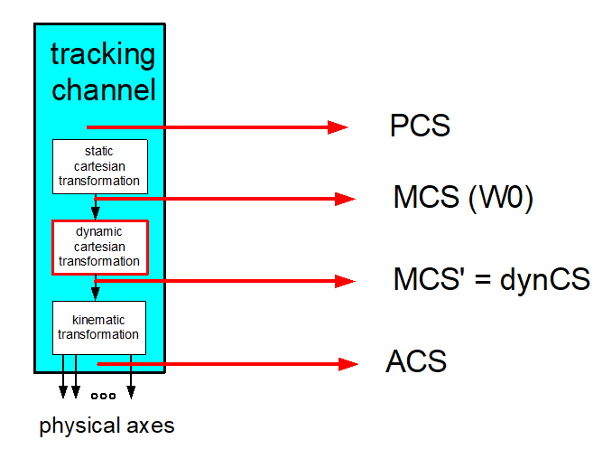

Display on the HLI
The input and output values of the dynamic coordinate system can be displayed on the HLI.

Tool centre point position (MCS)
Command position of tool centre point in machine coordinate system MCS. The value is refreshed in each interpolation cycle.

Dynamic CS position (MCS)
