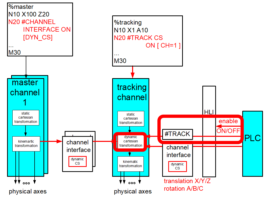

Switch via PLC command
Besides control of the tracking slave by an NC command, the equivalent command can also be sent by the PLC.
Switch via PLC command 1:
Dynamic coordinate system by PLC
PLC switching options (cf. #TRACK CS ON/OFF)
ON / OFF
Required filter time
(see FILTER…)
Reference to kinematic base
(see …KIN_BASE…)
Rotation sequence
(see.…ROT_TRANS…)
other options
(see …OPTION…)
Offset dimensions
(see …X/YZ… A/B/C…)
Relative as of activate/deactivate.
(see …RELATIVE…)
The PLC can explicitly control a wait to continue until slave tracking has been completely activated or terminated. In other words, the PLC only releases feed in the master channel after an activate/deactivate command, and after the status = INACTIVE / ACTIVE.
