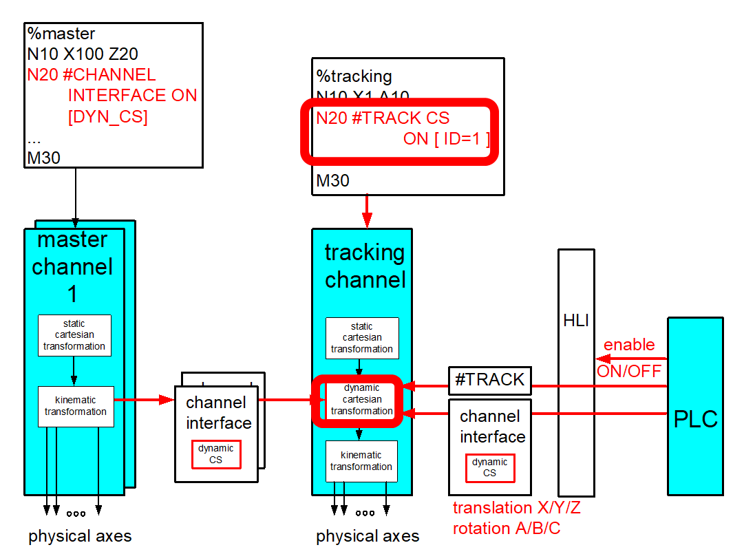

Switch via NC command 1:
Dynamic coordinate system by PLC
The enable command has the following syntax:
#TRACK CS ON            [ CH=.. | ID=.. [SET_ZERO | ABSOLUTE ] [OPTION=..]
                                         [KIN_BASE] [FILTER=..] [WAIT] [ROT_TRANS] [RELATIVE]
                                         [X=.. ] [Y=.. ] [Z=.. ] [A=.. ] [B=.. ] [C=.. ] ]
                                         [SIMU]  [LOG_FILE=..] ]

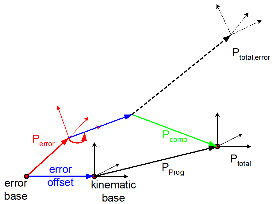

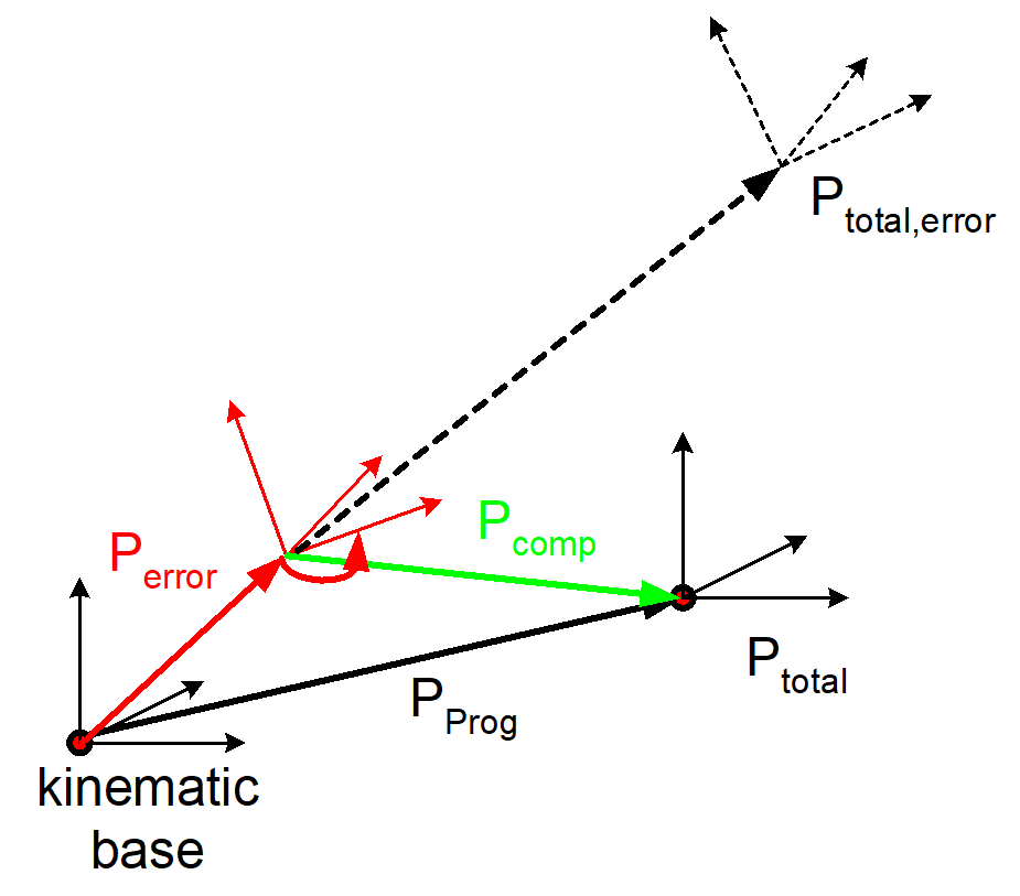

KIN_BASE
Fluctuations (red in the figure) in the kinematic based are compensated so that the slave TCP can be maintained at a stationary position. First specify the erroneous X/Y/Z offset and then the rotation C-B-A of the kinematic base.

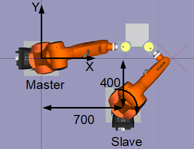

Application: Moved workpiece
This parameter specifies the static position offset of the slave to the master. In the example below this would be:
#TRACK CS […X=400 Y=700 C= - 90…]
Switch via NC command 3:
Two robots machine a moved workpiece
Application: Fluctuations in kinematics base
These parameters specify additional static offsets / rotations (blue in the figure) between the error angle of attack and the kinematic base.
#TRACK CS […KIN_BASE …X=200 …]
Switch via NC command 4:
Schematic of #TRACK CS command
