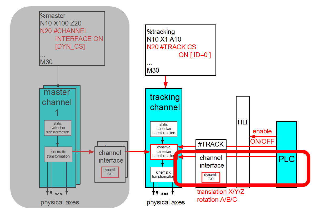

PLC as Master
A dynamic coordinate system can be defined by a CNC channel or by the PLC. The HLI has a control unit for this.
PLC as Master 1:
Dynamic coordinate system by PLC
States of the tracking slave
INACTIVE
The slave does not track the dynamic coordinate system.
ACTIVATING
The first time the tracking function is activated, the salve adopts the changes “softly” via a filter.
ACTIVE
The slave tracks the dynamic coordinate system.
DEACTIVATING
The slave “softly” decouples dynamic coordinate system tracking.
ERROR
An error occurred in the slave. The slave is unable to track the dynamic coordinate system.
