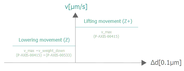

Option: Dynamic weighting of the lowering movement 1:
Reduction in velocity by dynamic weighting of the lowering movement

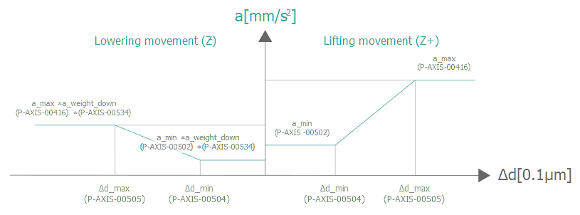

Option: Dynamic weighting of the lowering movement 2:
Reduction in acceleration by dynamic weighting of the lowering movement

kenngr.distc.v_weight_down
500
# Lowering movement at 50% velocity of P-AXIS-00415
kenngr.distc.a_weight_down
300
# Lowering movement at 30% acceleration of P-AXIS-00416
