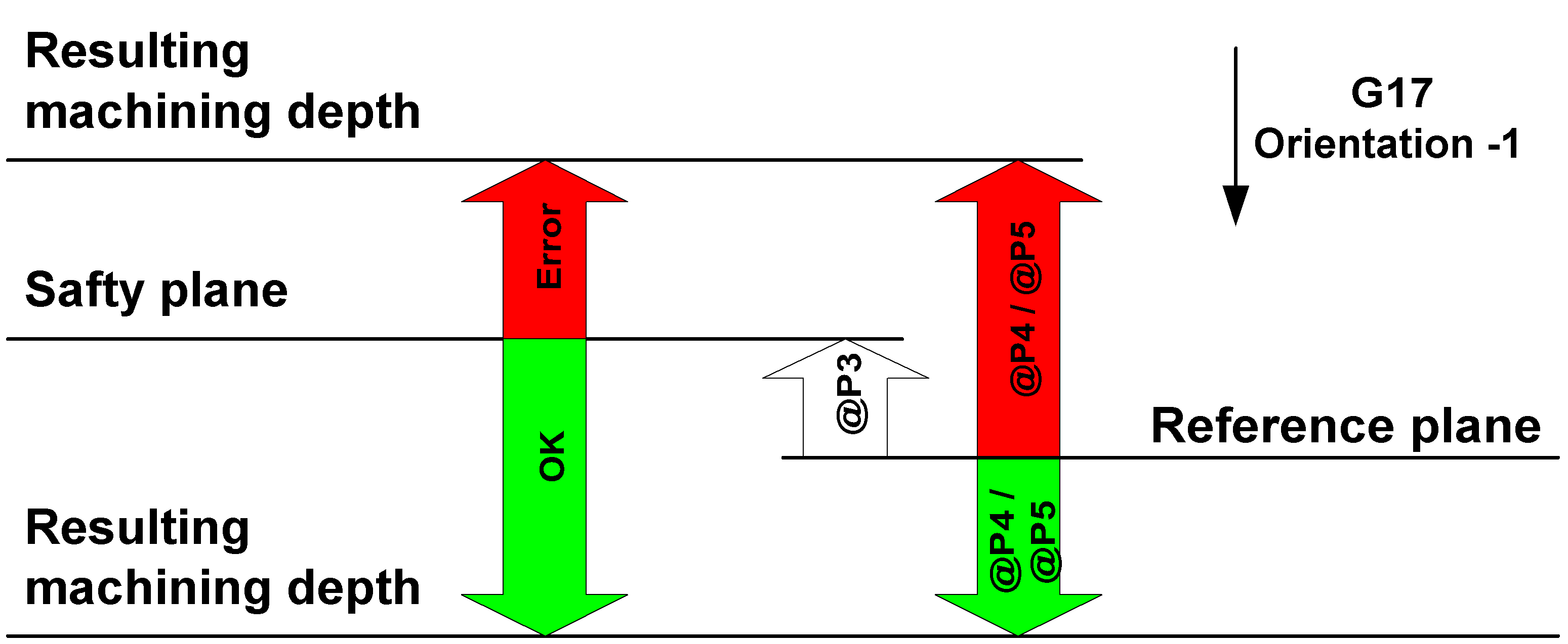

Incorrect definition of machining depth.
The machining depth is outside the safety plane.

Check and define the machining depth and the correct the input parameters.
