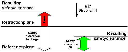

Description | Depending on the direction and based on the programmed safety clearance, a check is made in the cycle to determine whether the resulting safety plane lies below the retraction plane. This message is generated if the safety and retraction planes are equal or the safety plane lies above the retraction plane.
Response | Class | - | Error: Transition to error state. Complete reset of the NC channel necessary. |
Solution | Class | - | Check the safety clearance and correct the input parameters. |
