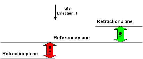

Reference and retraction planes incorrectly defined.
Depending on the direction, a check is made in the cycle whether the retraction plane comes before the reference plane. This message is generated if the distances are equal or the retraction plane lies below the reference plane.

Class
Check the locations of the return and reference planes and correct the input parameters.
