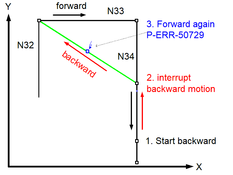

Delete distance to go for backward motion. Switch to short cut in forward motion.
If “Delete distance to go” is set during backward motion and a reversal is made back to forward motion on the short cut, FEEDHOLD is set and the warning P-ERR-50729 is output.
The short cut must continue in backward direction to the end. It is not possible to switch the motion direction on the short cut.
In the example, motion in N34 is backward.

Delete distance to go for backward motion 1:
Repeated forward motion in case of a backward short cut
