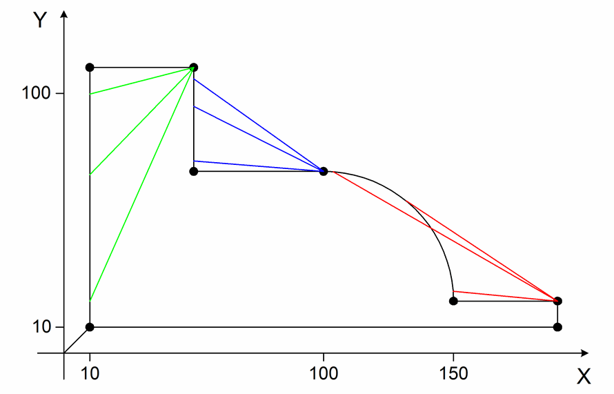

Request at different times
Programming Example
Vary the "delete distance to go” HLI signal

Request at different times 1:
Delete distance to go at different times
