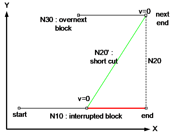

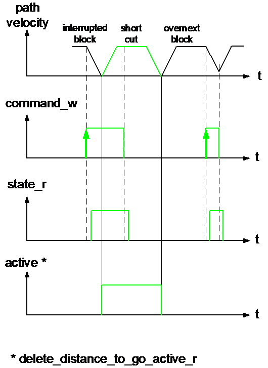

“Delete distance to go” is started by the rising edge of the signal at the PLC interface (commanded value in the control unit on the HLI). Signal detection (rising edge) is output in the control unit.
If the signal is cleared before the short cut is started, the original programmed contour is continued.
As long as the changed contour is executed, “delete distance to go active” = TRUE is displayed on the PLC interface.
Interface signals 1:
Delete contour path of single distance to go
Interface signals 2:
Delete PLC signal on the HLI for single distance to go

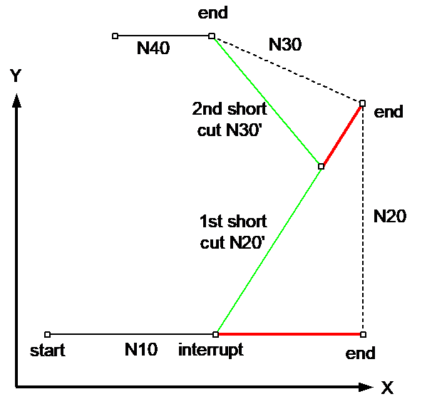

Delete multiple distances to go

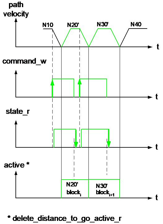

If “delete distance to go” is cleared and reset during execution of a “delete distance to go” block, this block is also interrupted and a short cut is executed to the target position of the next block.
The starting point of the second short cut can be defined by the block change (block number, block count).
Interface signals 3:
Delete contour path with multiple distances to go
Interface signals 4:
Delete PLC signal on the HLI with multiple distances to go
