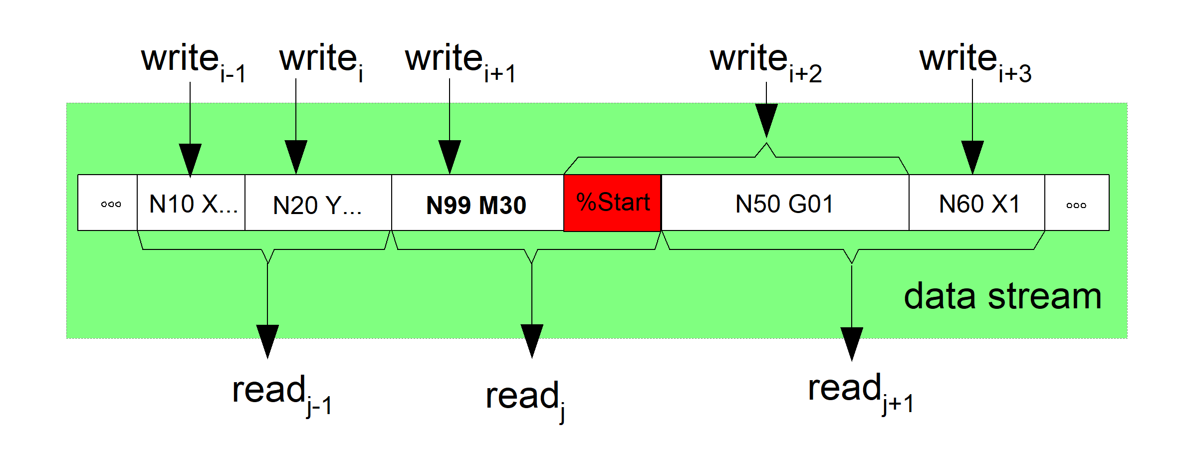

After normal termination of a streaming program, the remaining contents of the interface are retained but data already read with the program end data packet is discarded. That is to say that, after a program end M2/M30 or M17/M29 is written, he user should first wait until the streaming interface is read completely and empty. Only then can it be ensured that the next streaming program is correctly executed from the very start.

Behaviour at program end
Basic characteristics 1:
The area marked in red is no longer considered after M30
The following programming example requires the following parameters in the channel parameter list:

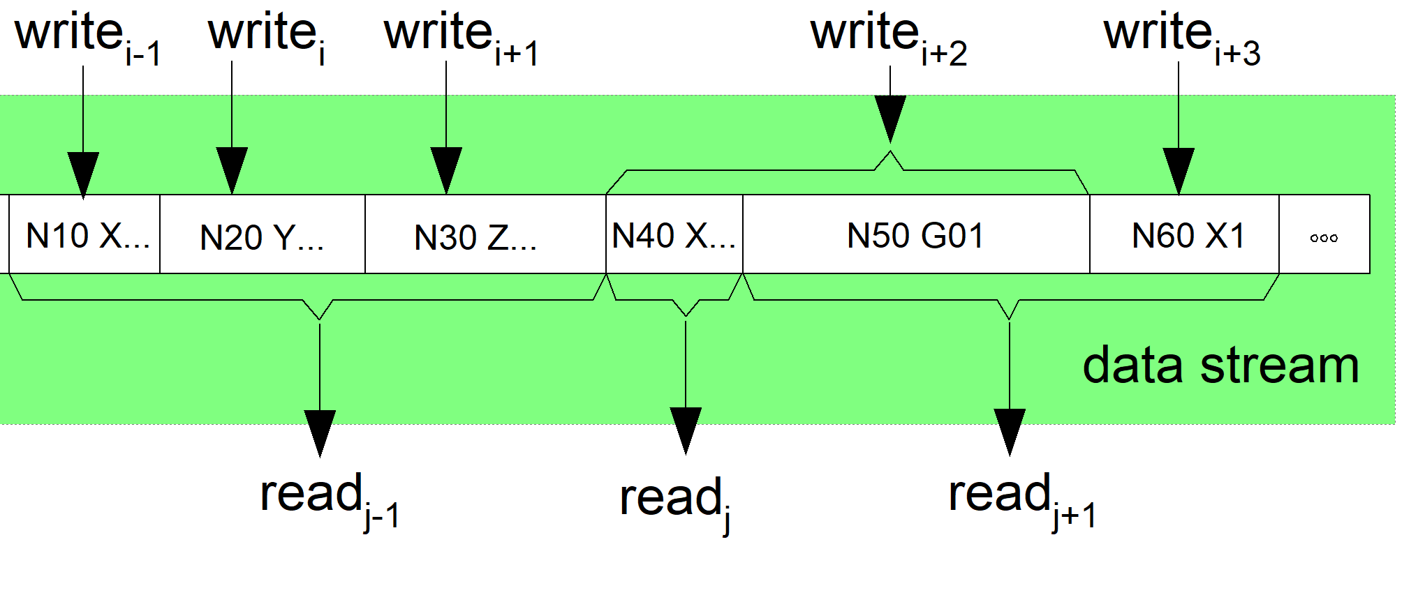

The data stream can be written via a corresponding interface object where one data packet can consist of one or several NC lines.
If there are several read accesses in succession, the individual data packets are sorted according to chronological access and are available to the CNC for read access as a data packet consisting of several lines.
On extraction, the data packets are no longer extracted singly. Instead, all data available at the time of the read access is extracted as a common data packet (program segment).
Basic characteristics 2:
A data packet may contain one or several NC lines.
Each NC line must be terminated by a carriage return (ASCII value = 13) and line feed (ASCII value = 10).
