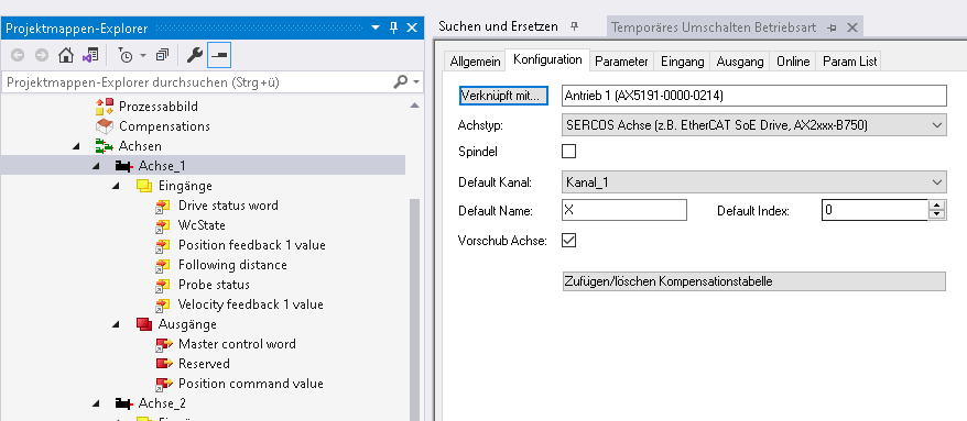

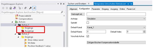

If you do not use P-AXIS-00790, you must switch the drive type (P-AXIS-00020) to "Simulation" for each individual axis when you switch to simulation. This results in losing all links to process data, see figure below. When switching back to the real drive type, you must re-establish the link to the correct drive for each individual axis
