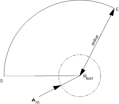

The programmed centre point coordinates must therefore lie in a circumcircle about the corrected centre point of the circle. The radius of this circumcircle corresponds to the permissible centre point offset Δm which can be set using the two parameters 'mittelpkt_diff' and 'mittelpkt_faktor':
Settings for circle centre point correction and radius compensation 1:
Zone of permissibly programmed centre points
