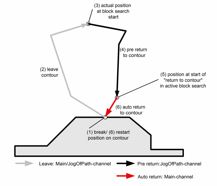

Manual restart to the contour (see Phase (4) “Pre-return to contour“) by means of an NC program can also be executed by a JogOfPath channel. Switchover between restart channel (JogOfPath) and block search channel always takes place when the axes are at standstill (see FCT-C15 Jog of path).

Sequence
- Normal program start
- Program interrupt and channel reset
- Move to any position
- Switchover to JogOfPath and start program in block search channel
- Start manual start program in JogOfPath channel
- Switchover to block search channel and enable restart by PLC
- Automatic restart of residual path difference
Remark: As opposed to starting on a JogOfPath channel, manual restart in a block search channel can only take place before the block search starts.

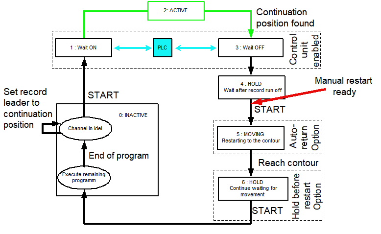

![]() | Channel block search can be started even though the channel axes are still released to the JogOfPath channel (PLC sets HLI.channel.SuspendAxisOutput). |
The flow diagram below shows a manual restart to the contour executed by a JogOfPath channel before the PLC enables START. Before the block search channel continues, channel output is switched back to the block search channel
(HLI.BlockSearchChannel.SuspendOutput = FALSE,
HLI.JogOfPathChannel.SuspendOutput=TRUE).
