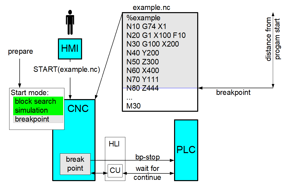

Type 6: Breakpoint without block search
Set a breakpoint without block search
If a breakpoint is to be set without a previous block search, this can be done by specifying the block search type SIMULATION = 6.
In this case the program is processed normally with an additional breakpoint (grey and white section).
Type 6: Breakpoint without block search 1:
Additional breakpoint
