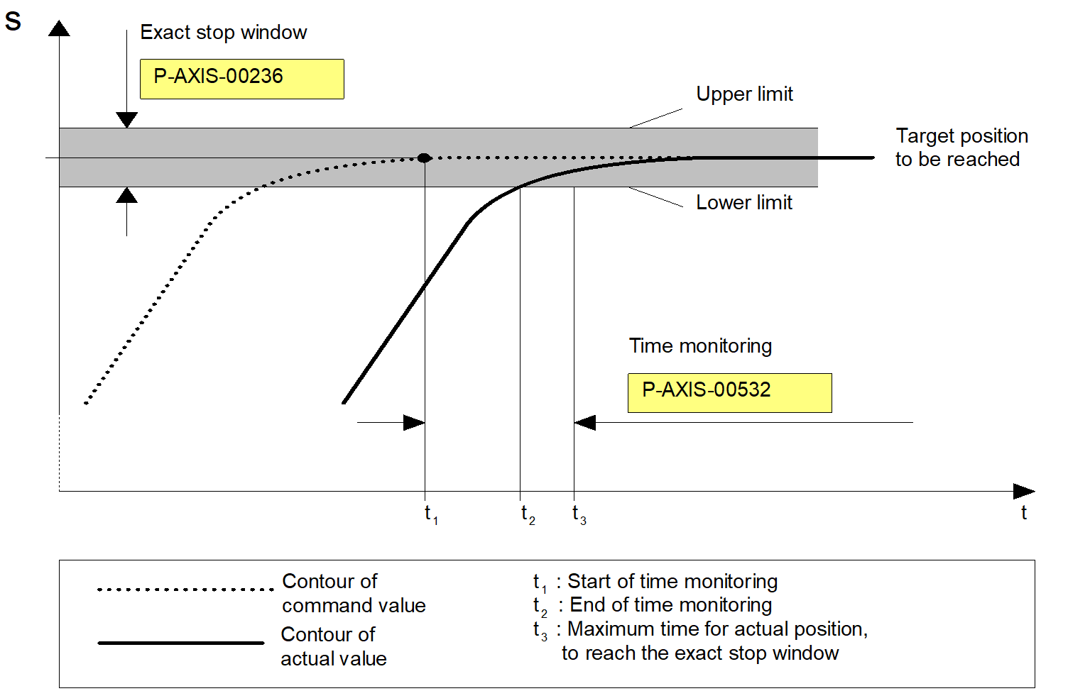

Position monitoring consists of the following steps:
- When the axis command position reaches the programmed target position, the timeout is started (time t1).
 - Timeout is deactivated when the actual position of the axis is located within the exact stop window (time t2). The exact stop window is configured by P-AXIS-00236.
 - The actual position must be located within the time t configured in P-AXIS-00532 in t3 the exact stop window.
