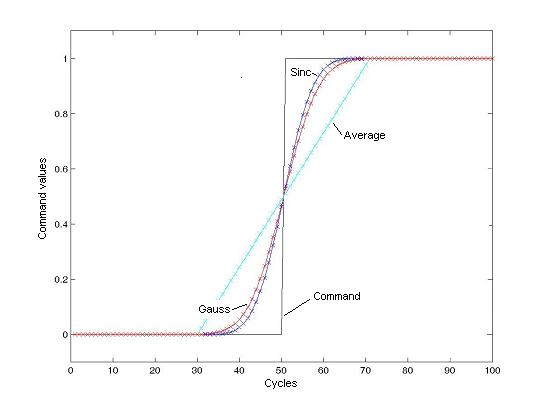

The HSC average filter is an acausal time range average filter. It acts within the frequency band as a low-pass filter. - HSC-NoVib
The HSC NoVib is an acausal FIR filter. The internal filter core, which depends on its natural frequency among other things, suppresses oscillations.
Step response

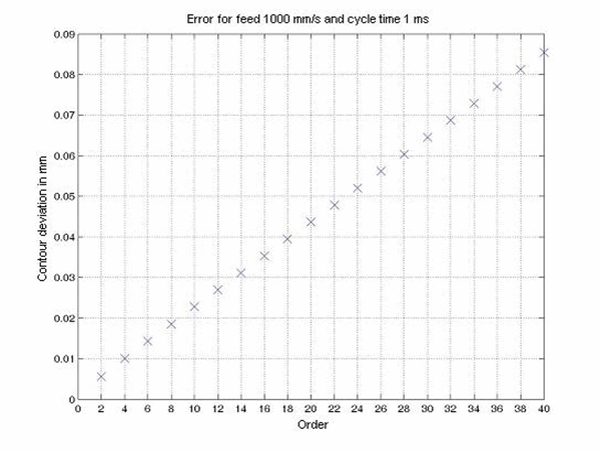

Contour deviation adjustment aid
The contour deviation when using HSC axis filters is composed of three components.
- Cycle time
- Filter order
- Feed rate run
The following simple relationships apply:
- Double cycle time = double error
- Double feed rate = double error
- Double filter order = double errorThe graphic below represents a cycle time of 1 ms and a feed rate of F1000 at a 90° corner. With different marginal data, the filter orders must be uprated according to the ratios above.
The figure above assumes a corner velocity of 1000mm/s and a cycle time of 1ms.
