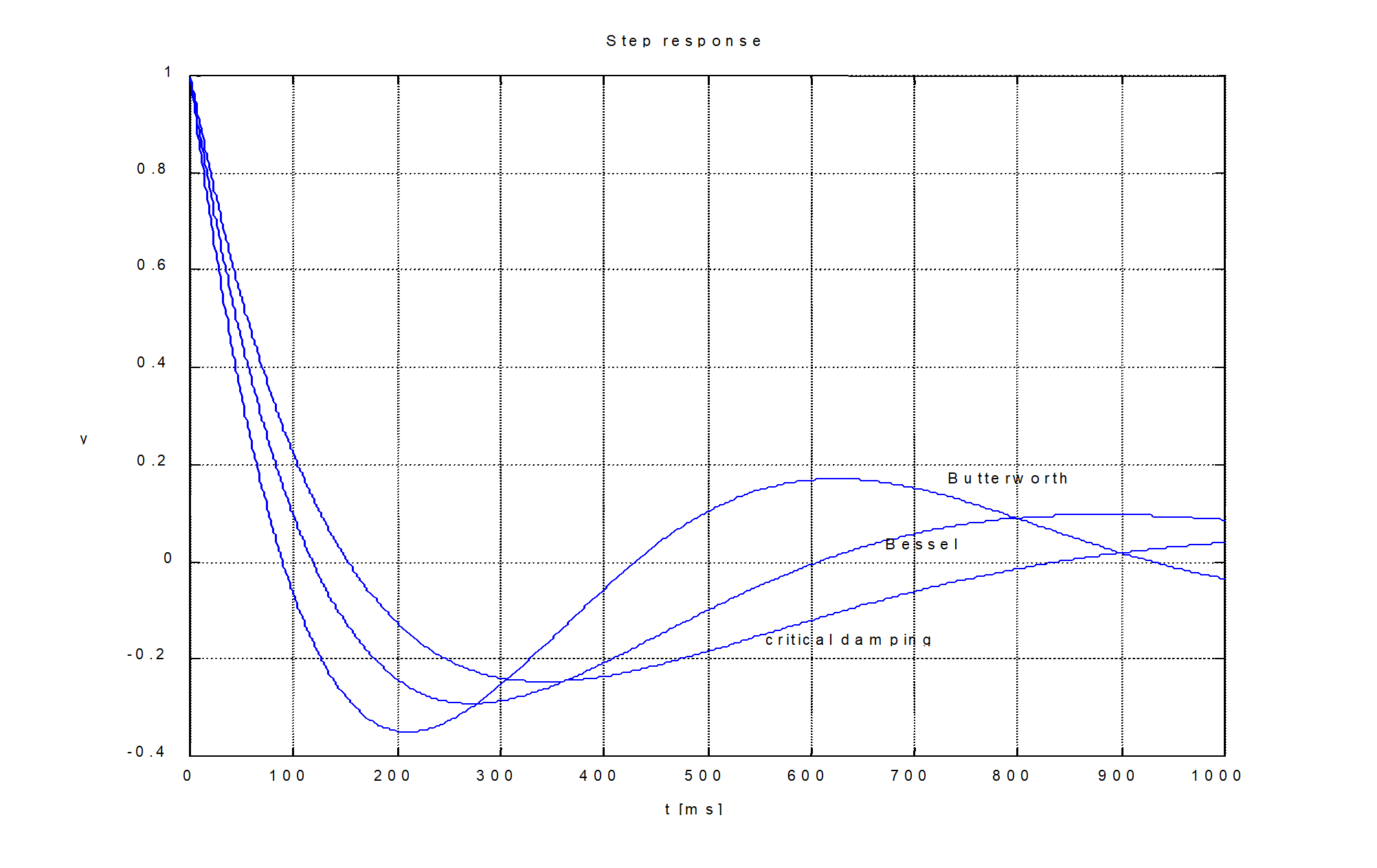

Step response
Contrary to low-pass filters, the filter output values of the step response in the case of high-pass filters fluctuate about the stationary value.
High-pass filters 2:
Step response of high-pass filters (4th order)
