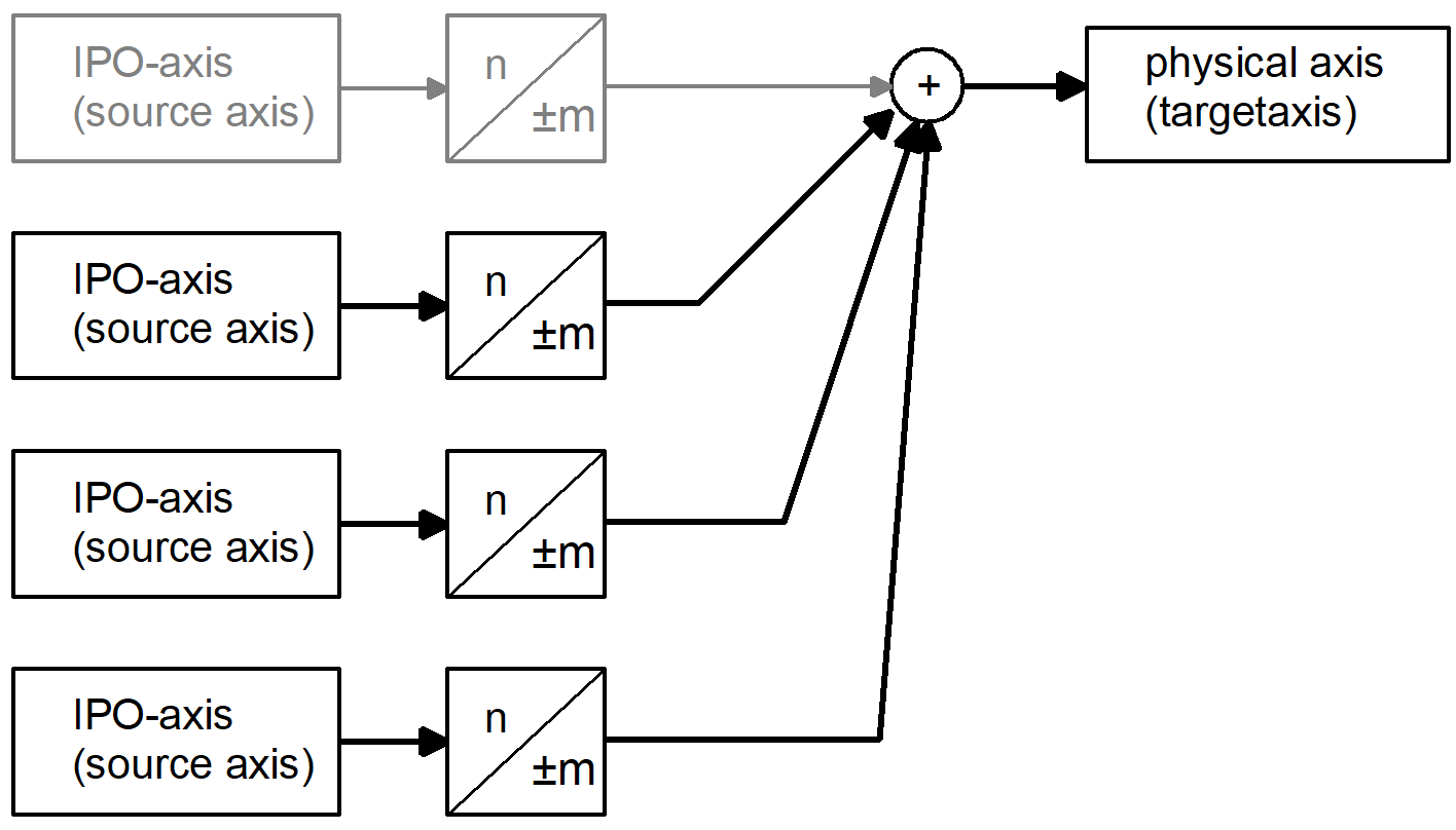

Description 1:
View of the difference between source and target axis
In this example several source axes act on a physical target axis. The interpolator axis that normally moves the target axis need not necessarily belong to the source axes.
This section is a description of the resulting dynamics of the target axis.

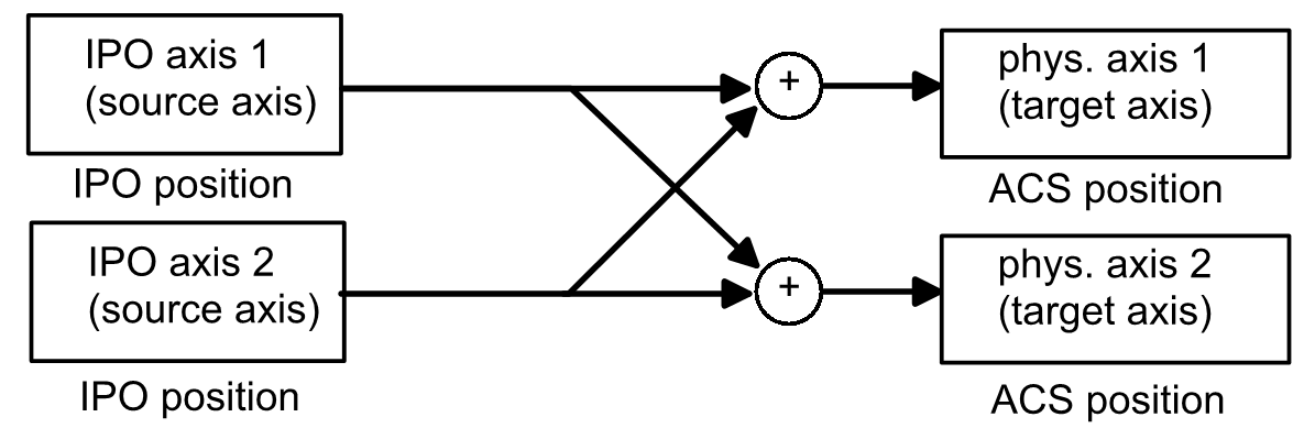

Description 2:
Schematic of coupling specification
To calculate the IPO position of axis 2, the IPO position of axis 1 must already be known. The deadlock cannot be resolved and results in the output of error message ID 70410.
