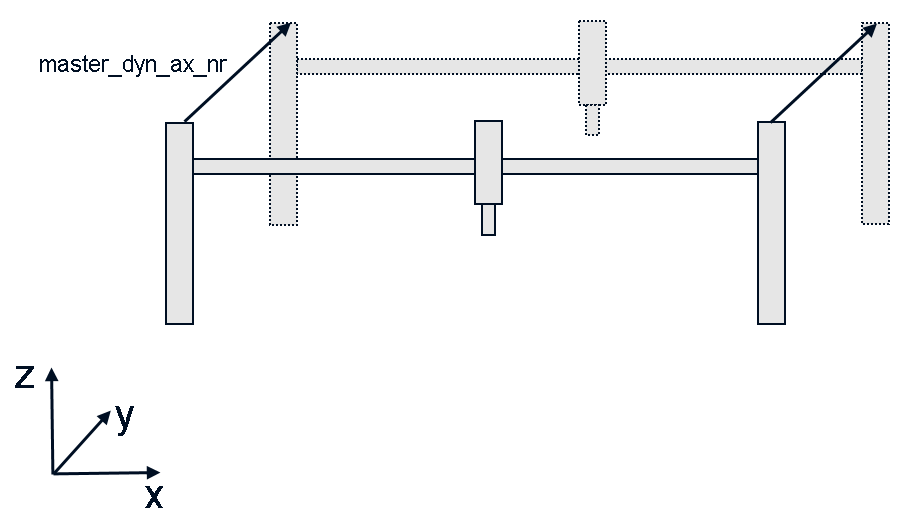

Crosstalk compensation modes
Three modes are provided for crosstalk compensation.
Mode 1:
An acceleration and the related compensation value are specified. With accelerations less than the specified values, the compensation value is linear interpolated.

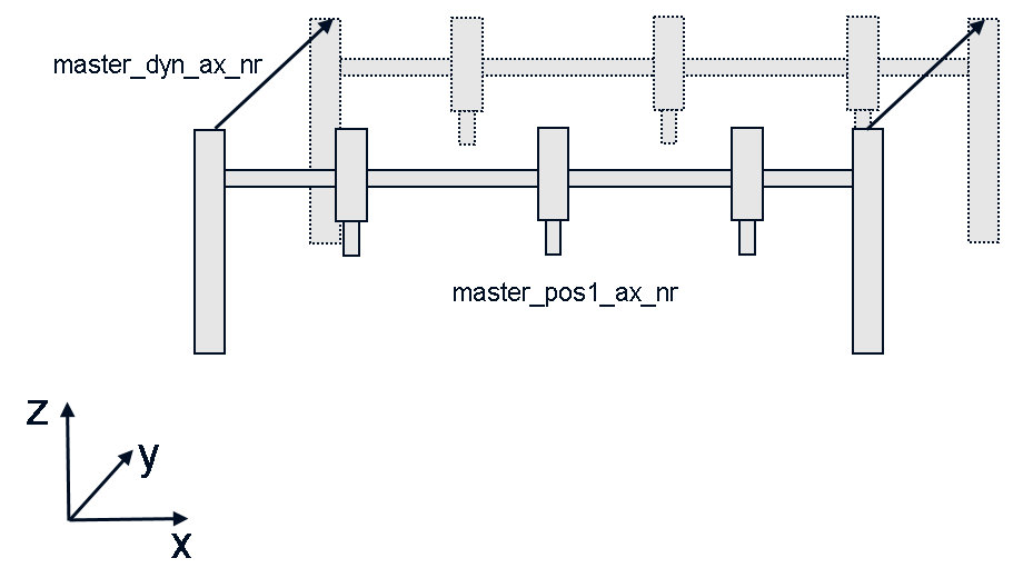

Mode 2:
Compensation is calculated using an adaptation axis which is obtained by the user conducting three measurement tests. The measurement tests are conducted at various positions on the adaptation axis. Compensation is then calculated using the position of the adaptation axis and the current acceleration.

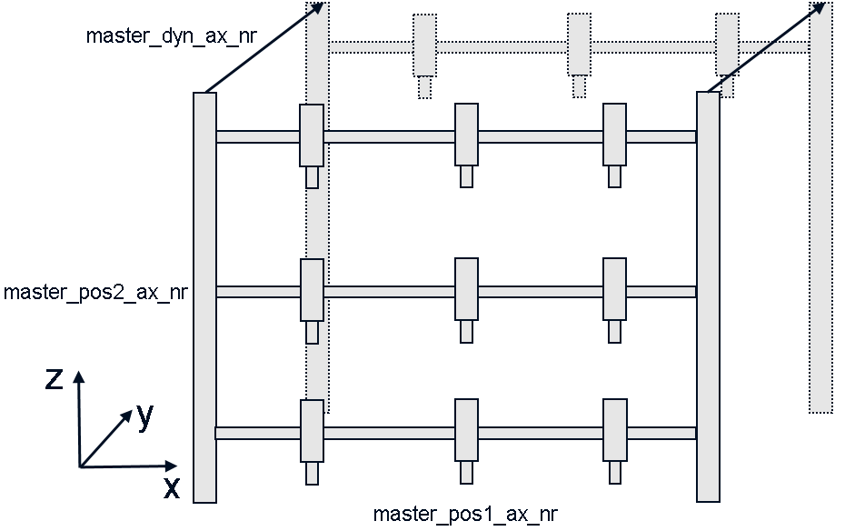

Mode 3:
Two adaptation axes can be specified. The user can enter up to 15 measurement tests in the compensation value list. Crosstalk compensation calculates compensation values using surface interpolation.
Here, please note that the measurements must cover the complete workspace. If this is not the case, incorrect compensation values can occur with positions outside the specified measuring range.

master_pos1_ax_nr | UNS16 | Logical axis number of the first adaptation axis. |
master_pos2_ax_nr | UNS16 | Logical axis number of second adaptation axis |
