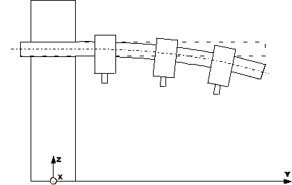

Cross compensation permits the compensation of rectangularity errors or errors that arise due to deflection of the axis.
Compensation process
Cross compensation (also called sag compensation) permits the compensation of an axis position depending on the command position of another axis.
The axis whose command positions influences the compensation value is called the master axis. The axis for which compensation is active is called the slave axis.
A master axis can also be the salve axis of another master axis.

- A master axis has one or several slave axes.
- A slave has only one master axis.
- Cross compensation can also be used for the master and slave axes of a gantry combination.
- A compensation value can be specified for each interpolation point.
- Interpolation between interpolation points is linear.
